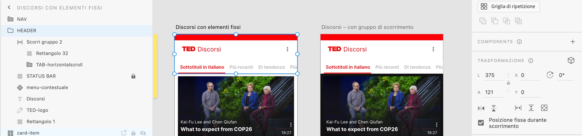

    Dec 26, 2022 8:43 PM UTC
    Hi @AkinGn thanks for getting back to me.
    This stops working as soon as you create a group and place some elements in it.
    Here is your prototype updated: https://drive.google.com/file/d/1dyJnyRWje9ZaMA2JK-02JMjewhK2Fohs/view
    Thanks in advance.
    And this is actually important as it is common to create an header with just the tabs area that scroll.
    Dec 11, 2022 10:38 AM UTC
    Is there any update about this bug report?
    I'm facing this issue again,
    Steps to reproduce:
    1. Create an artboard taller than the viewport height (simulating a vertical scrolling mobile experience)
    2. Create a group intended for horizontal scrolling within the viewport area
    3. Apply the Horizontal Scroll option in the sidebar (optional: preview to ensure it's working correctly)
    4. Check the box for Fix Position When Scrolling
    As soon as I check the "Fix position when scrolling" option the horizontal scroll won't work anymore.

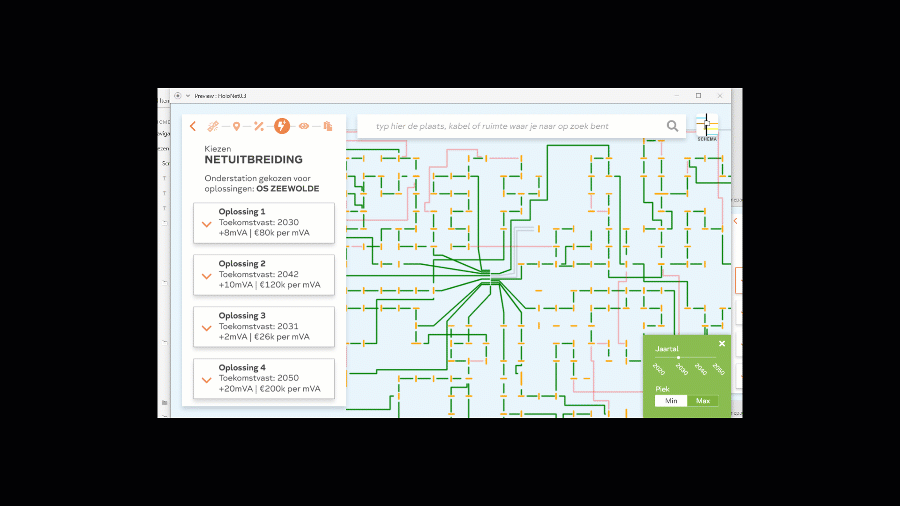

    Nov 9, 2020 8:55 AM UTC
    When using horizontal & vertical scroll with fix position, the scrolling stops working after a couple of interactions.
    It's effectively the same bug as https://community.adobe.com/t5/adobe-xd/scroll-groups-not-working-with-fix-position-when-scrolling/m-p/11570738?page=1
    Can you assist?

    Nov 9, 2020 1:52 PM UTC
     - XD 34.212 | Windows 10 Enterprise 10.0.17763
     - Happens in all files
     - See gif with occurence below:
    It simply stops after a couple of interactions, the number of which differs every time. 
