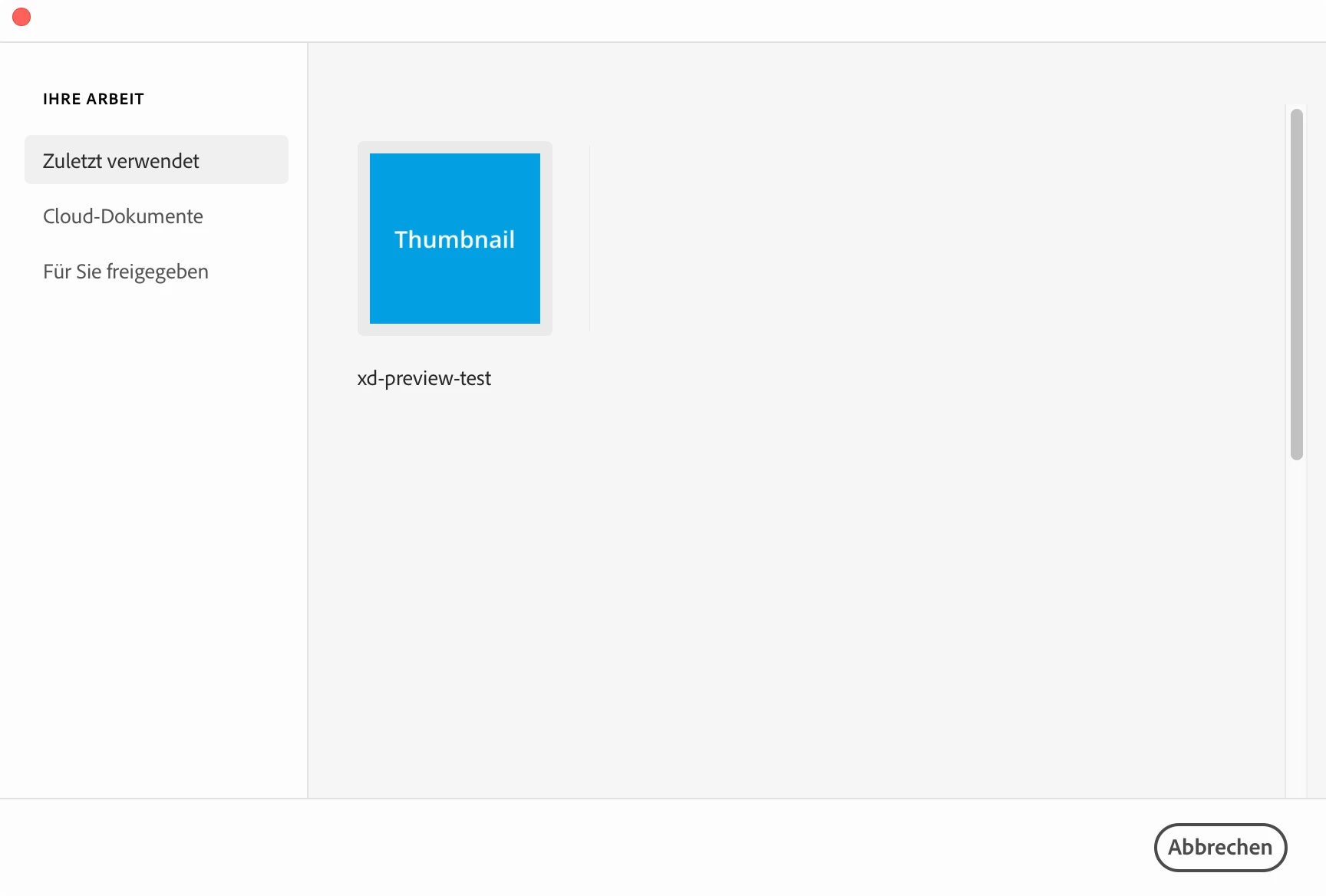

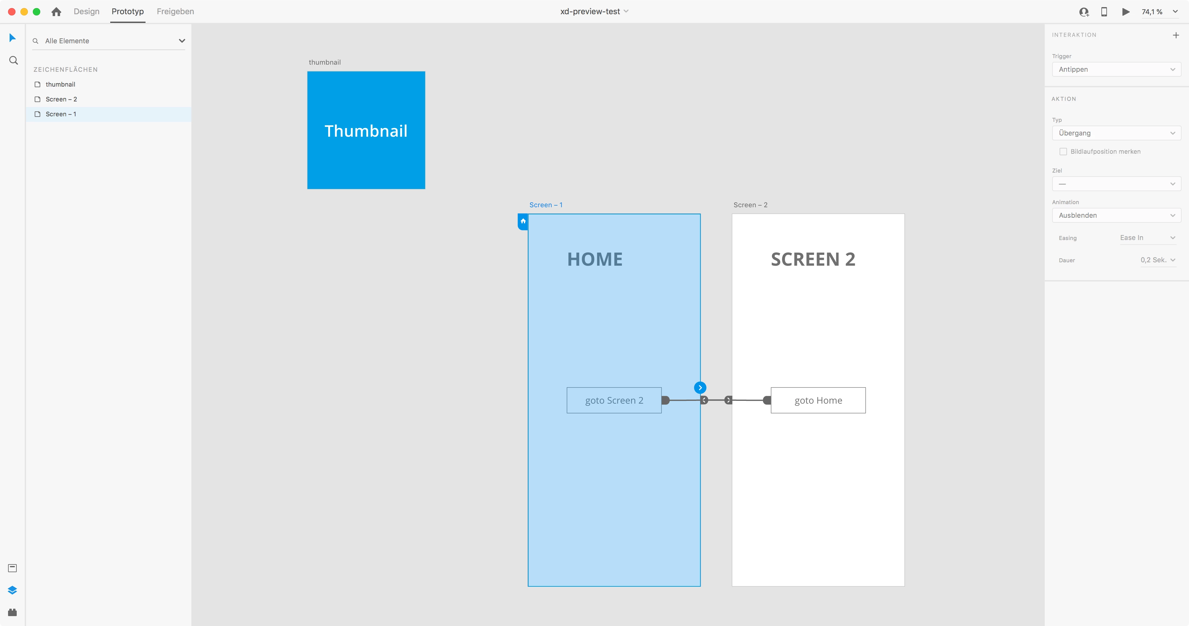

    The problem occurs when you mark an artboard as the HOME artboard (icon with the house) in prototype mode and not if an artboard is renamed to "Home". The problem also persists when I save the file locally.
    Here you can see the behavior:
    No HOME set in prototype mode:
    Top left artboard is shown in preview => correct

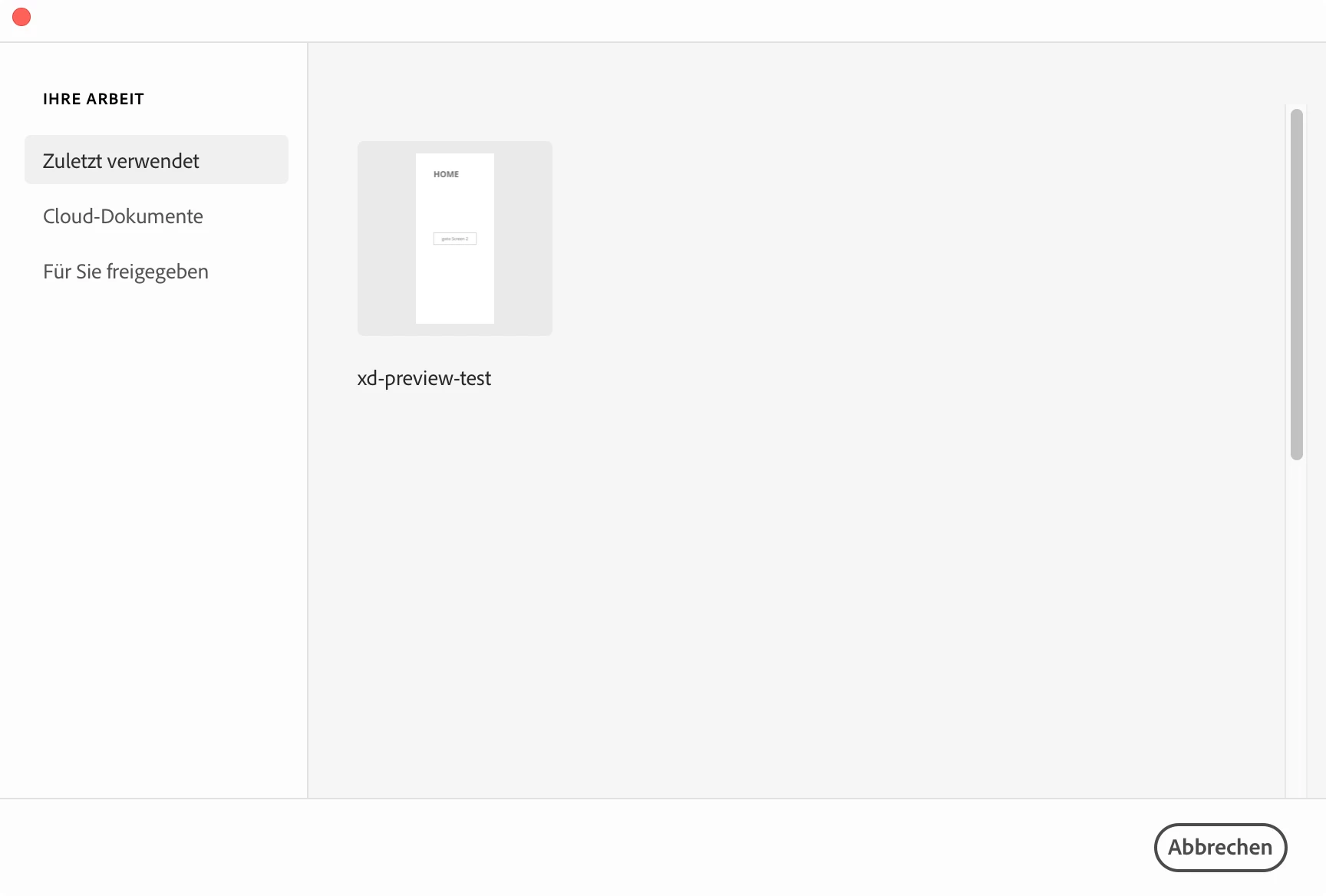

    Artboard "Screen – 1" is marked as HOME (the blue icon with the house)
    The HOME-Artboard is shown in the preview instead of the the top left one:
