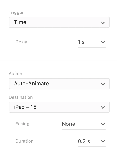

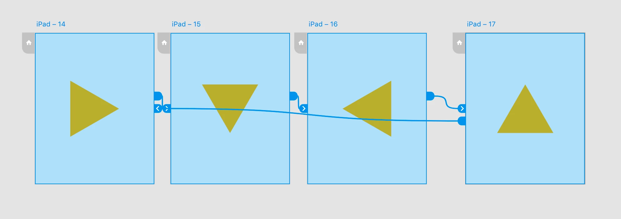

    here are two images: one with the whole sequence (from left to right) and one with my settings.

    I've run into a problem that I think in the 3D world is referred to as a "gimbal lock" (or the equivalent in 2D space). So I have created a simple animation with a triangle for my perpetual animation. The triangle is supposed to rotate clockwise 45 degrees between each frame (4th frame "connected back "to the 1st frame) thus completing a full rotation on the 4th frame. However, when going from the 3rd frame back to the 1st, the triangle spins instead spin backwards (counterclockwise) back to the 1st frame. Somehow I think that XD messes up the positions of the points of the triangle, not knowing where to "place" them in 2-dimensional space. Or something like that!
    Weirdly enuff: if I don't use Auto-Animate on the 4th frame the animation works, but it doesn't look so good.
    Any ideas as to what I should do? I've tried searching "gimbal lock" on the forum but answers only relates to After Effects.
    Regards
    Johan
