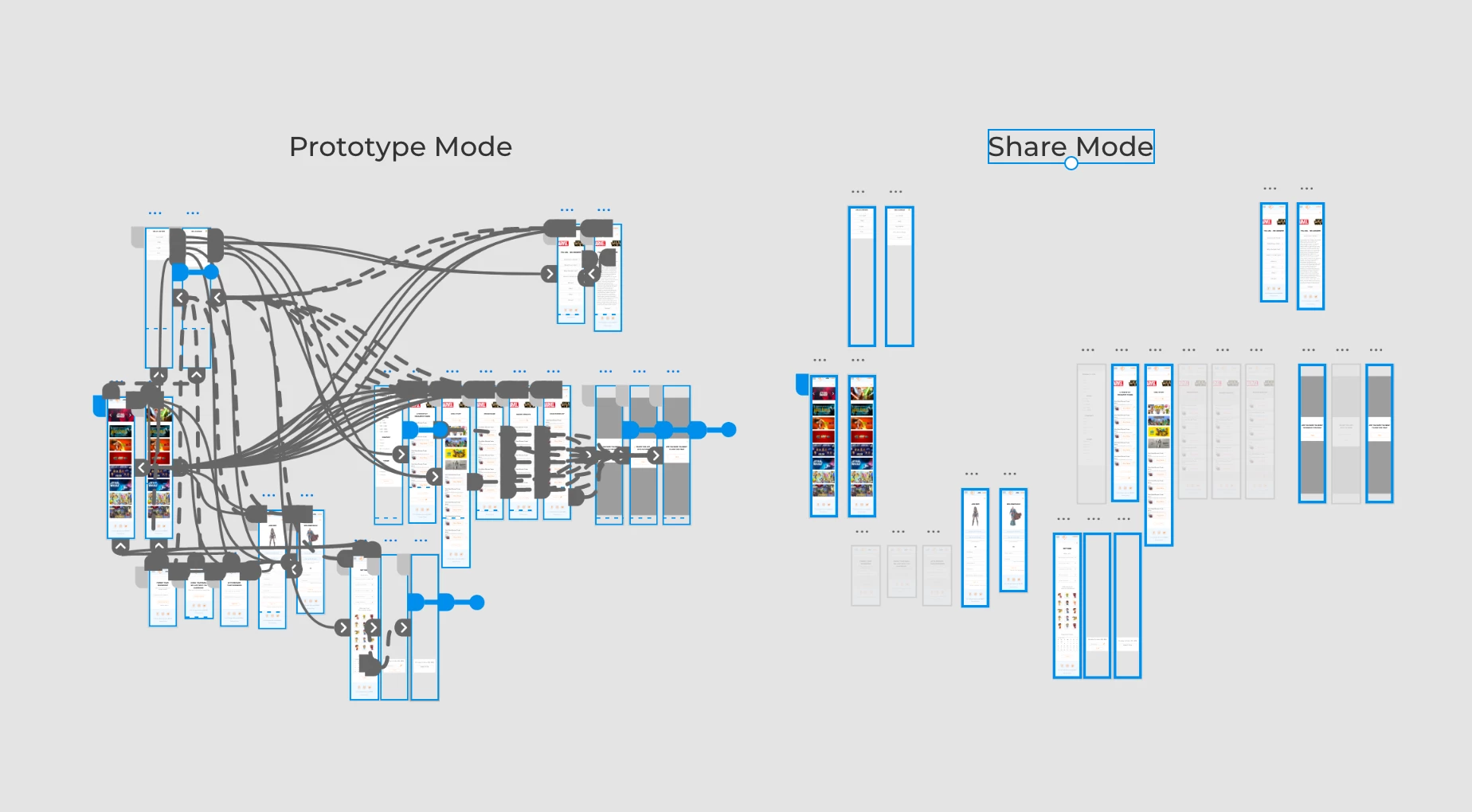

Here's how I would expect the share functionality to work:
You click the share tab. You get to create a link and select ANY artboards you want to share with that link regardless of what's going on in the prototype tab (it can select the prototyped ones by default if there are any and select all of the artboards by default if there are no prototyped artboards). There should be a "select all" button because sometimes people design a lot of screens. Then you can OPTIONALLY pick a home artboard to share with THAT specific link and you can simply click it again to remove the home artboard (it can default to the first one in the series if left unset).
Then, I simply click "update link" and it updates the link (because my first step was creating or selecting a link). At any point I can rename links and use the checkboxes to control what UI is being shown when someone visits the link.
So basically I'd recommend making the LINK higher up in the hierarchy and let the user make some much more intuitive decisions for that specific link when it comes to which artboards to share.
I see your point here about being able to publish all artboards. Given that there is a home artboard already set on canvas, and there is no direct way of removing it, you are unable to publish all screens. We understand that this can be annoying.
Please note that we are going to provide the ability to set and unset of a Home artboard in Prototype mode soon. Apart from that, we are also thinking about providing a way to publish all artboards from Share mode, irrespective of whether you have wired a flow or not.
To your point about selecting artboards in Share mode and not respecting any wires set in Prototype mode, would that not be confusing? Why would you define home, wire screens like a flow in Prototype and not want any of that to carry over into Share mode?

I have a problem with a project - When trying to share the file for review or for dev, the share function doesn't include all of the artboards but all of the artboards are wired and connected to the home page and I can't figure it out! This is the first time I'm having the problem and I have no idea how to fix it. Can anyone advise? (Image attached.)
{Renamed by MOD}
