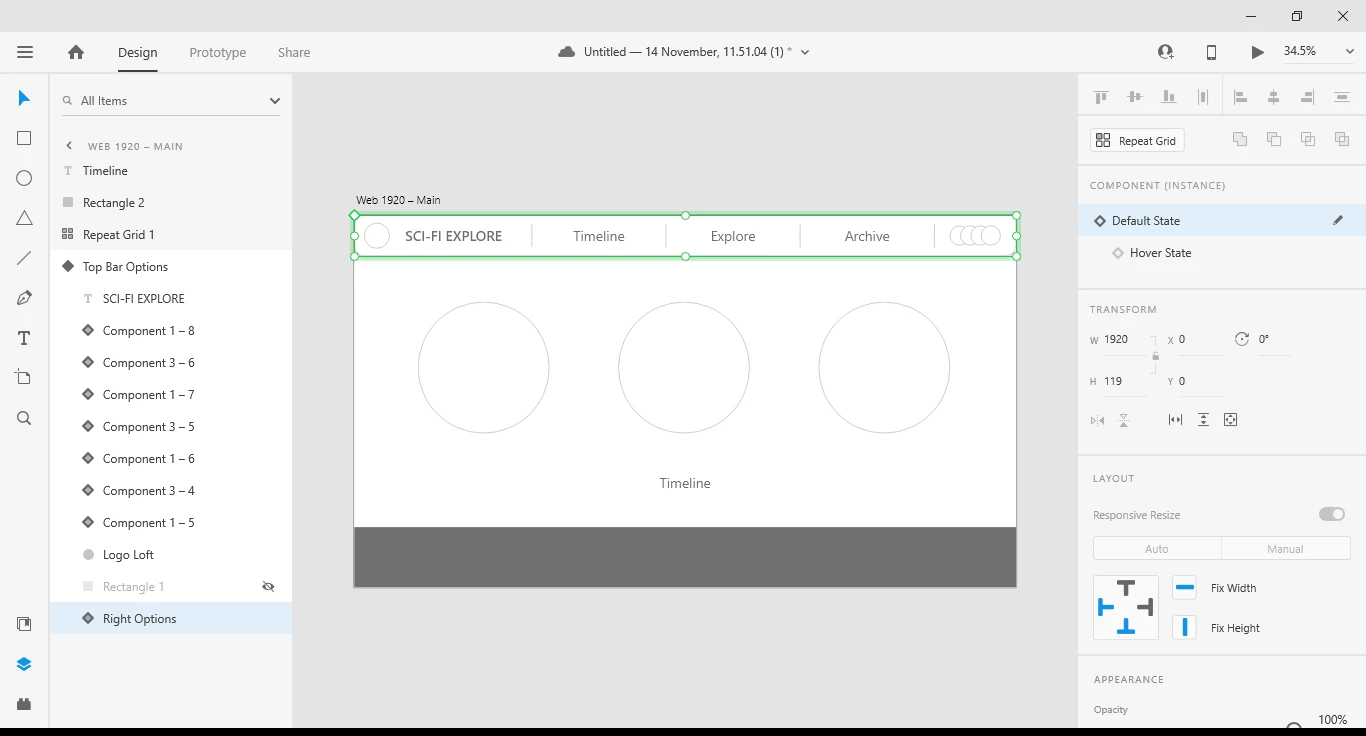

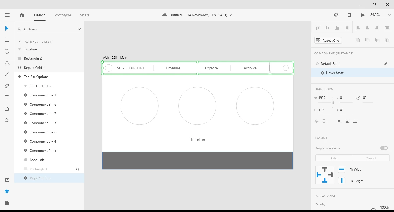

As seen in the file attatched, I want the top bar to split into two states on when hovering over the profiles (4 circles on the left).
Since the only way I can make the top bar split is to make it part of the component group with the profiles, it is now activating the hover state when hovering over any part of the bar.
I tried to create a shape a layer above but its still activating the hover state even if its above the created shape.

    So I figured out how to work around this (in case anyone has this issue in the future)
    To "fix" it, another component needs to be created on top of it but it needs to also have a hover state (the hover state doesn't have to be different than default; there just needs to be a hover state). This means that the original component won't be triggered if the mouse is on an area where that original component and the new invisible one is overlapping.

    Sorry for the bad explnatian. I am trying to make it so that the top bar splitting is triggered only when hovering over the profile section (the 4 circles on the left) but currently it is triggered when hovering over any part of the top section.
    Here are the layers if it helps:
