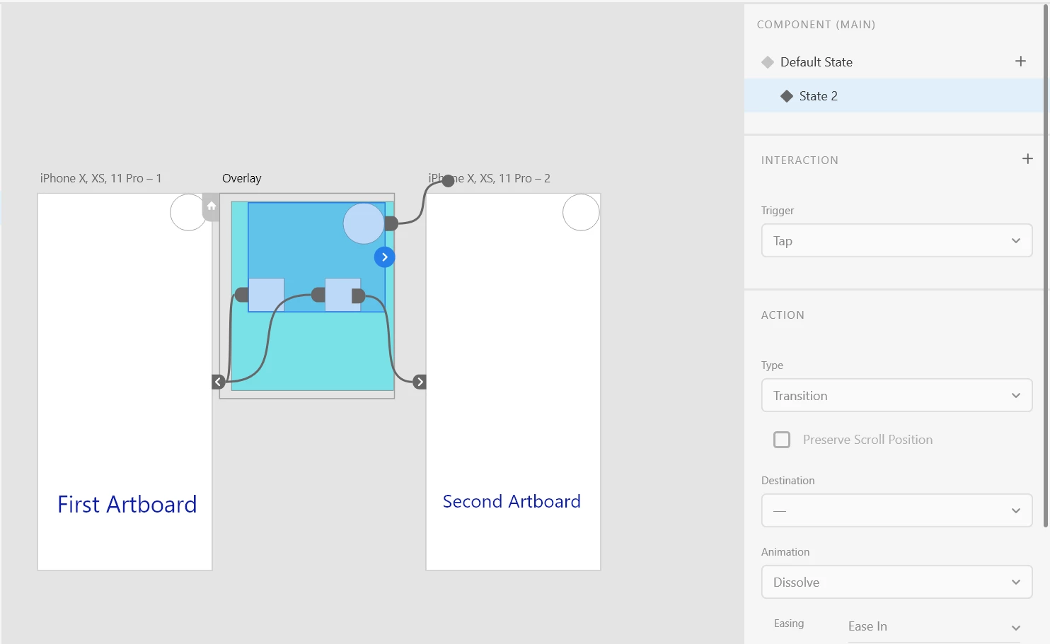

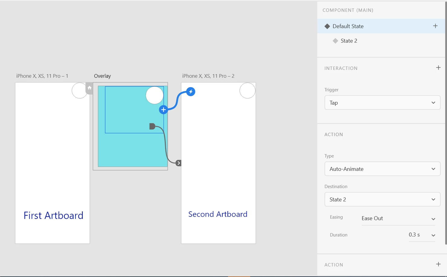

What you want can be achived using component states.
Your overlay card can be built as a component with 2 states.
Hitting Save would return to previous artboard.
Hitting Cancel would switch to the second state of the component, with your "Are you sure?" dialog.
The "Yes" button in the second state would be wired to 'Previous Artboard', and the "No" button will switch back to the default state.

Rishabh_Tiwari
Oct 2, 2020 4:01 PM UTC
Hi there,
Thanks for reaching out. I tried reproducing this use case on my end and if I understood this correctly we can achieve this. Please have a look at this sample prototype: https://xd.adobe.com/view/6ae8a620-9f80-43b4-b29c-34ade9dc535d-3fbb/
Let us know if this helps or if you need any further assistance.
