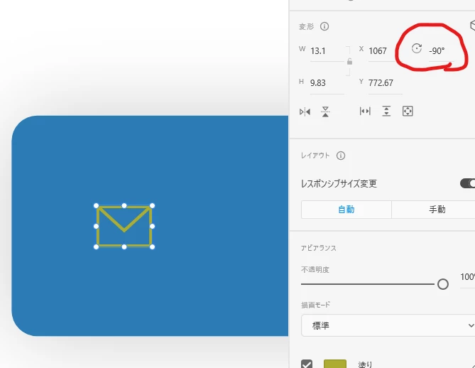

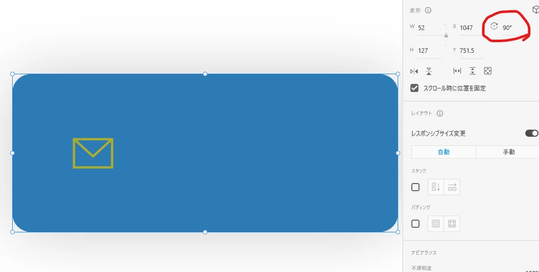

- xd file is created by Mac, and I export by Windows.
- When exporting an svg icon, it will be rotated.(incorrect)
- parent component: rotated 90 degree / child component: rotated -90 degree.
[dev environment]
Windwos 10 / XD:v43.0.12(latest)

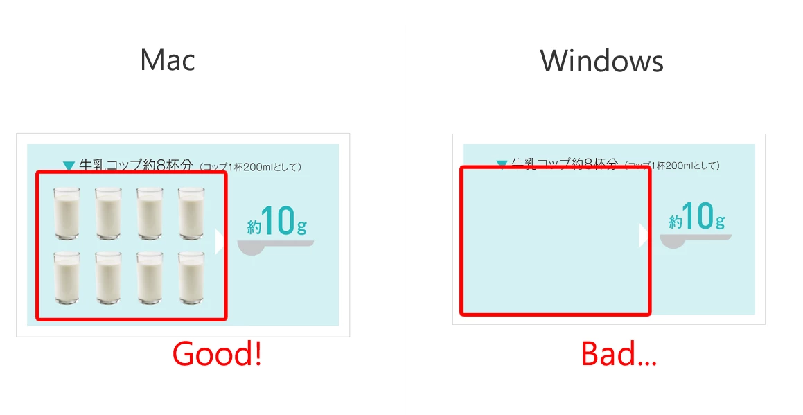

> - embeded CMYK image is disapper in Windows. if Mac, correct.
I attach a screenshot showing this issue.

Sep 2, 2021 10:23 AM UTC
another problem:
[status]
- xd file is created by Mac, and I open it by Windows.
[dev environment]
