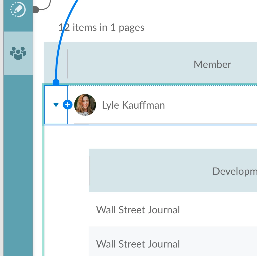

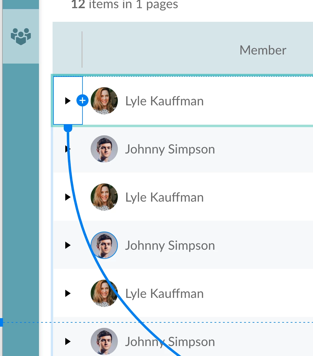

I am having an issue with the tap trigger when making a prototype. I have two artboardss on which I set a tap trigger on the exact same UI element respectively. When tapping on the element, it will trigger transition to the other artboard, and vise versa. It works on one of the artboard, but when I try to link back to the artboard from the other, it doesn't work. The two artboards have the same structure. The only difference is that the artboard that is working has the component set to a none-default state, and in the other artboard, the same component is set to the default state. Please check the screenshots.

This tap trigger works. It will link to the below artboard.
This tap trigger doesn't work. It should trigger the transition back to the above artboard.
