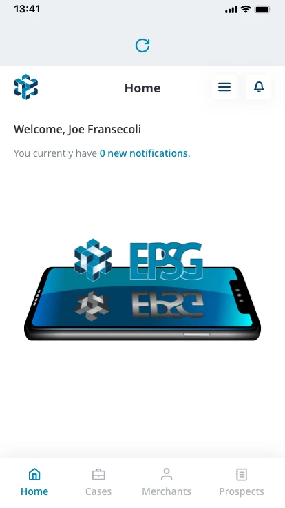

I am trying to go from screen A to screen B, where screen A has a toast that says "Successful removal!" and screen B is the same screen without the toast.
The other specifications include: same layer names, same layer levels on the artboard, Auto-Animate, Ease In-Out, and a duration of 0.6s.
The transition ONLY works if I do not add a delay (if I add a delay of anything other than "0.0 s", it doesn't transition!)
I have updated XD, restarted the app, my computer, and it's still the same.
HELP! This seems like something on XDs side, and not mine, but let me know!

Hey so I figured it out:
Becaue I had a JSON animation (a refresh icon animation from Lottie), the whole artboard time delay wouldn't work! I had to remove the JSON icon animation and it worked fine. I used a refresh icon instead and spun it around myself using an extra artboard.
