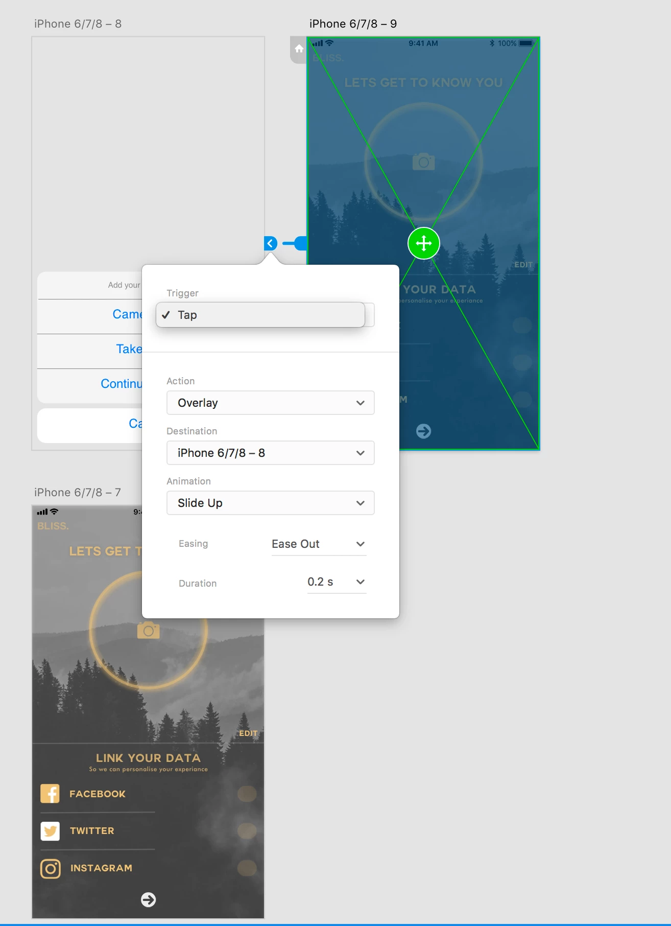

Time trigger not showing in prototype mode in XD.
I'm updated to 12.0.12.10 version of Adobe XD but the time trigger is not showing on the prototype part of xd
Can anyone help me?

Oct 4, 2018 5:15 PM UTC
Hey there,
It's a bit tricky and we should work to improve this but...timed triggers can only be applied on the artboard itself. So just make sure you select the source artboard first when associating the transition to your overlay.  The option should then be available.
Jan 10, 2019 11:34 AM UTC
I dont get the transition option.
Dellis_Author
Oct 4, 2018 2:57 PM UTC
For some better context,
I have tried 'check for updates' just in case it was displaying the wrong version, reloaded creative cloud and Adobe XD but the feature still isn't showing.
