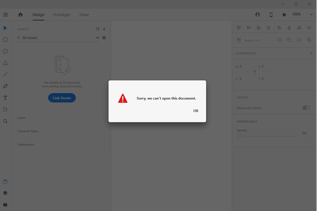

Unable to load cloud documents getting Error: Sync Conflict
Hi All,
I'm facing "Error: Sync Conflict"
I can't open my file if I try to open it just show "Sorry we can't open this document"
for more Understanding, I've attached SS over here.
Pleases suggest some solution how can I open my files
Thanks
- Ankita

Sep 23, 2020 5:38 AM UTC
Hi Rishabh,
Thank you for your Suggestion
But, It's not working for me I can't open this file in my XD
  • Are you connected to a private network or a managed network like a work or school network?
    - I'm using a privet network
Thank you
- Ankita

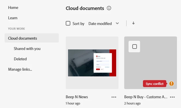

Rishabh_Tiwari
Sep 24, 2020 2:42 PM UTC
Thanks for trying, Ankita. Could you please check if you are able to see this document here: https://assets.adobe.com/cloud-documents
If yes, please try downloading the file from there and then try opening the file and let us know how it goes. I'd also like to know if this is happening with this specific file or multiple files? Please share a screenshot of the About XD info page.
