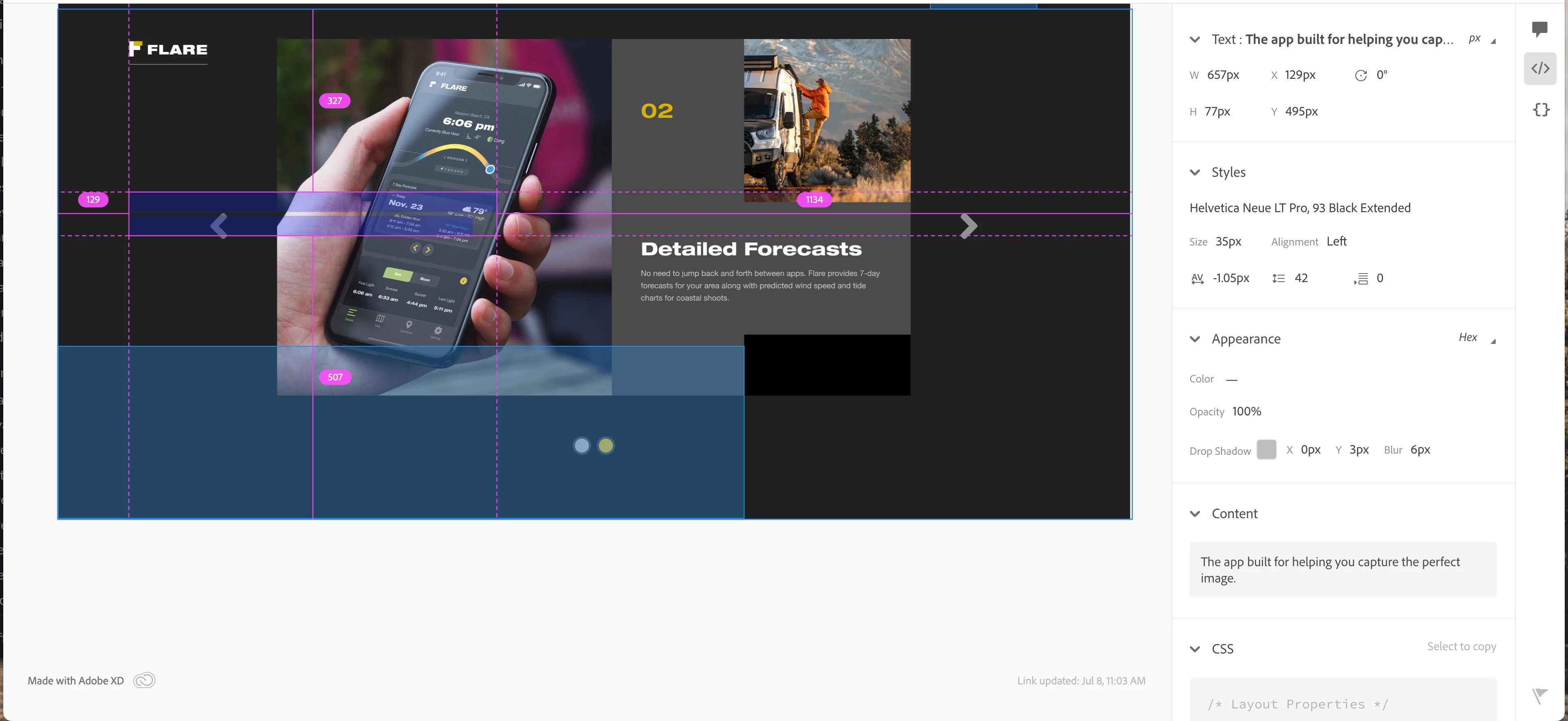

Is anyone having issues using the spec tab and trying to pull info from the scroll groups? Seems you can only pull spec info from above the fold. Anything else in the scroll group doesn't work properly. This was never an issue before. I attached a screen grab below (can't grab the image, can't grab the carets, the blue grid lines that are showing are from the image above the fold.)

Okay, so I checked out the file and it indeed seems to be a bug.
@HARSHIKA_VERMA Inside a scroll group, any elements that are not visible and have to be scrolled to cannot be selected while in specs view.
I've attached a video of the issue - I should be able to click on Element 2 and see its dimensions, but I can't. Here's the prototype and the .xd file.

@Spas K. Thanks for looking it over appreciate it. It doesn't have to be a scroll group; I just sent a sample mock to recreate the issue since I couldn't share the current project I'm working on. I will use a fixed header going forward. Thanks for the suggestion.
