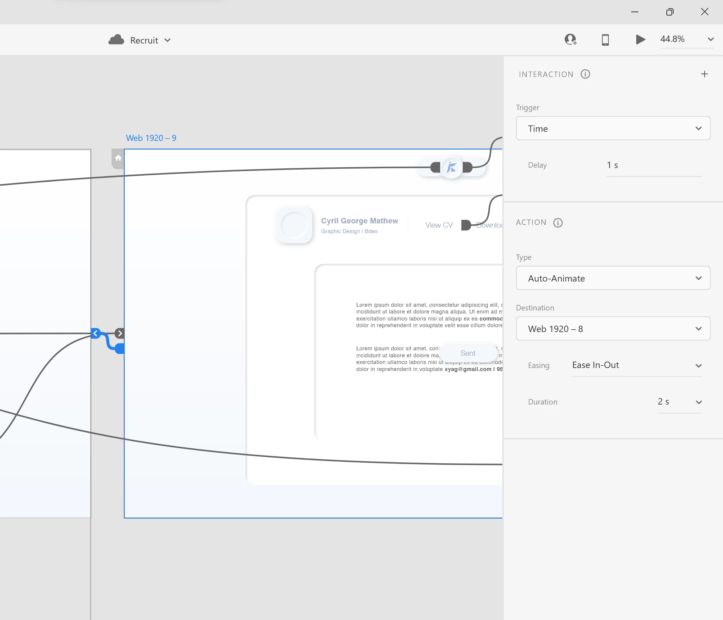

Hey, I have a simple page transition with time and it works when I have delay set to 0s but as soon as I change it, the time transition won't work.

Thanks for sharing the video, Ashish5E96. I tried replicating your workflow at my end and it seems to be working fine for me.  Please see the video below-
I would suggest you to please check if there are any element on the artboard that has the same time set up i.e 1s which might be taking the priority. Please also share the details of your operating system.

Hi Ashish5E96,
Thank you for reaching out and sorry for the trouble. I am unable to reproduce the issue at my end on my windows machine. Could you please also check out this article: https://helpx.adobe.com/xd/help/create-prototypes-with-videos-in-xd.html and see " Understand interactions and video playback behavior " this section to ensure that everything is set up properly.
If you still face the issue, please create a short video of your worklfow and share with us so that we can try replicating at our end.

Thank you for your speedy reply, the issue still persists. I will link my video for your reference.
