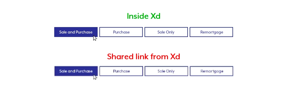

IvnvuAuthor
Jul 13, 2020 1:34 PM UTC
Due to NDA contract I cannot show you fully, but I can share with you a small part of it so you can see the difference. One Image is from the Xd prototype, and the blurry one from the same prototype, but the shared link.
