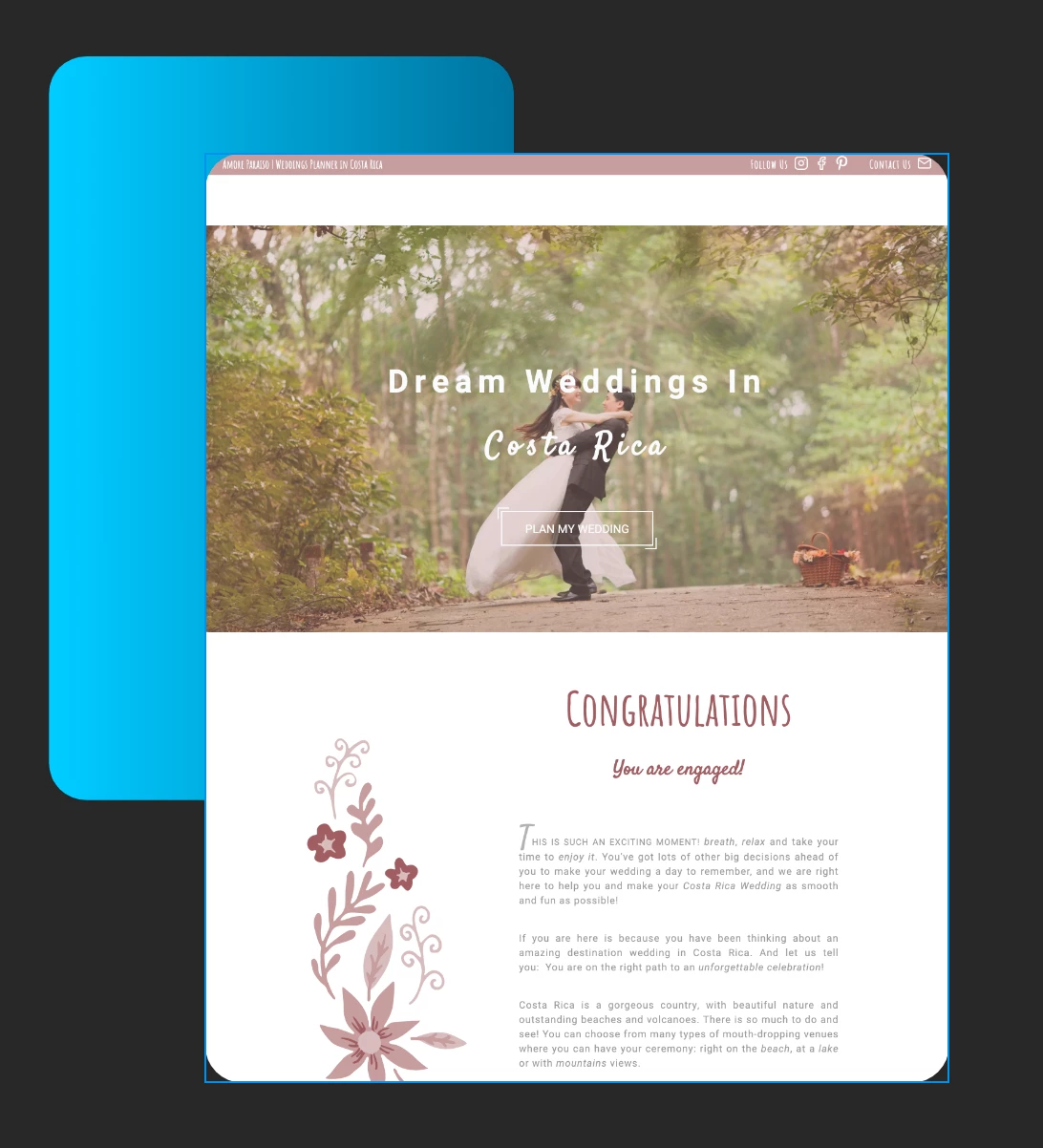

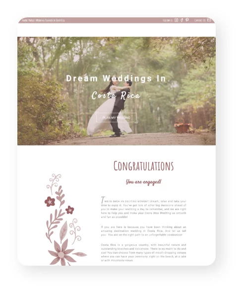

    Thank you. I had completly misread that option. Thought it was to select if we want to export 1x or both (1x adn 2x).  Here's another issue though that you might be able to help. If exporting an image masked in a container with box-shadow the image is exported with a white 'margin' aroung it. Anyway to avoid it? Same issue with border radius. See attachement:

    Not sure about the shadow, as you can't apply it to a masked group (which needs to be fixed by the way... 😉 )
    You can set the image inside the mask as "Mark for Export" then do the batch export.
    I'd say it's a bug and this post was wrongly treated:
    https://adobexd.uservoice.com/forums/353007-adobe-xd-feature-requests/suggestions/34920958-export-original-image-inside-a-mask-not-just-the
