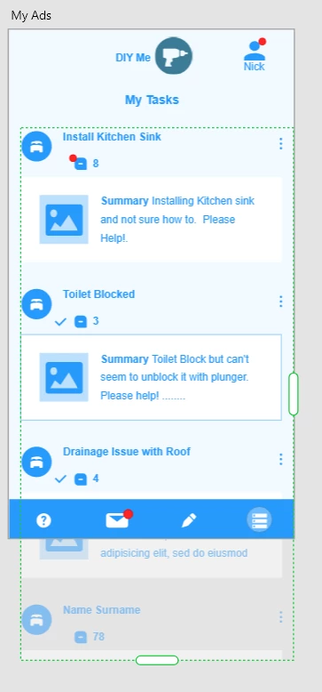

Why would it scroll if you have the viewport height set larger than the artboard? Reduce that to say 667.
