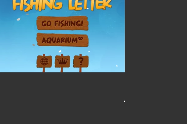

Hi!
Like everyone here, I saw that Air 2.7 is now out, very exciting stuff!
So to test that, I just take an old .fla (a game) who work very well with Air 2.6. I copy-past the .swf / . xml / .provision / .p12, and when I export...
It's like the game is in high resolution (the image is in 960x480). So I thought maybe I have something wrong in my file, maybe in the .xml I forgot the "high" instead of "standard"... I check everything, nothing wrong... I try to change the display mode in CPU and surprise, it's working! Fullscreen mode / Standard display it's cool. I change for GPU mode and again, the screen is in high resolution and reduce by half my app!
Does anyone else have this weird bug? Or maybe in GPU it's in High Resoution by default?
CPU mode is cool by the way, but I NEED GPU (my game is built around that for better performance).
Thanks!

    @Mike0431 Are you setting stage quality to high (stage.quality = StageQuality.HIGH) in your application?  If so, try setting it to medium (or just don't set it at all) and you should see performance and visuals in line with AIR 2.6.
    In AIR 2.6 (and earlier) on mobile platforms, stage.quality was capped at medium.  Explicitly setting the stage quality to high had no effect.  This changed in AIR 2.7, and the stage quality setting now directly affects the parameters used to configure anti-aliasing performed by the GPU when using the GPU render mode.  As you may have discovered, however, this can have a huge performance impact and needs to be applied very judiciously.

    June 16, 2011
    Hi everyone!
    And thank you all for sharing your ideas, it's why I love Flash Community!
