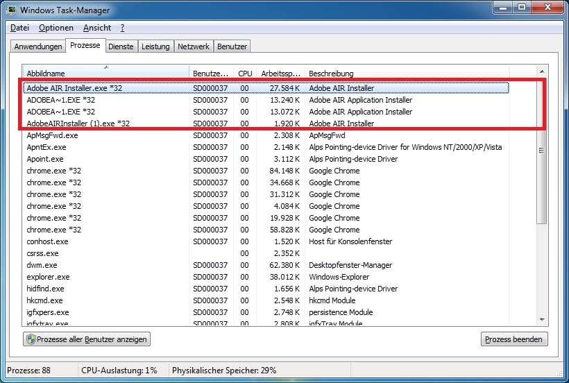

Now I have 4 Adobe air instance in the task manager(see screenshot)
2* Adobe Air Installer
2* Adobe Air Application Installer

Thanks for giving that a try.  I'm not seeing anything wrong in the install log, but you shouldn't being seeing hung instances in your task manager.  Could you try creating a new, temporary, user account and seeing if you can install from there?
