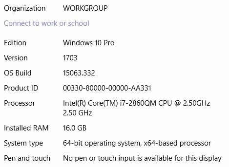

I get the administrator won't allow install as the error message.  When I try to follow the troubleshooting instructions and remove the old installation, it won't uninstall using control panel.  In  another post on the forum, it said to post the install log to get some help.  I am running Windows 10 Creative version on an HP PC.
