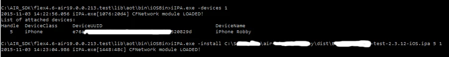

Any progress on a fix for this? I haven't been able to build to my iOS device for weeks. I tried the patch mentioned above but I'm still receiving errors. I tried manually installing the app from command line via mb81‌'s comment but still no luck. Am I doing this incorrectly? The app is not showing up on my device.
Nov 3, 2015 9:58 PM UTC
Hi soccerob,
There is a workaround that could make you able to continue building for you iOS devices.
I am currently using Adobe AIR 19 with these steps:
1. In Deployment Tab, uncheck the "Install applications on the connected iOS device" check box
2. Publish to generate the IPA file
3. Install the app in your device with this command line:
"<ADOBE AIR SDK PATH>\lib\aot\bin\iOSBin\iIPA.exe" -install application.ipa 1 1
This command installs on the first iOS connected device found the file "application.ipa"
I am deploying all my iOS apps this way until a real solutions is out there.
You could put that command line into a batch file that you can call installipa.bat doing the process a little bit easier.
You can even change "application.ipa" with a %1 and pass the ipa file to the batchfile through parameter something like this:
"<ADOBE AIR SDK PATH>\lib\aot\bin\iOSBin\iIPA.exe" -install %1 1 1
e.g. installipa.bat application.ipa
I hope this work for you.

At the moment I manually upload the file by calling iIPA in the following way:
iIPA.exe -uninstall mypackage 1 1
iIPA.exe -install myApp.ipa 1 1
I enqueue this to my build script.

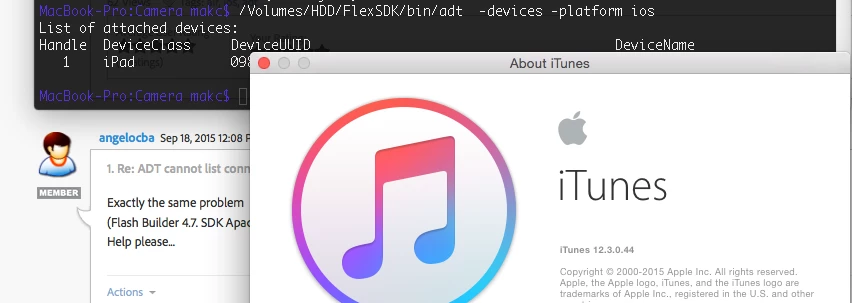

Sep 20, 2015 12:51 PM UTC
Ok, Mac OS does not seem to be affected:
Sep 20, 2015 1:25 PM UTC
Also does install ok.
