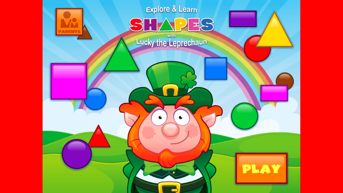

iPhone 5 grab

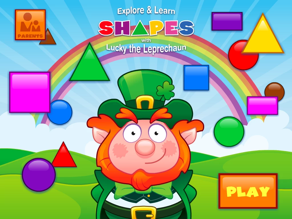

iPad 2 grab

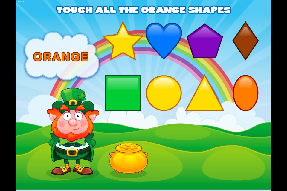

iPhone 4 grab

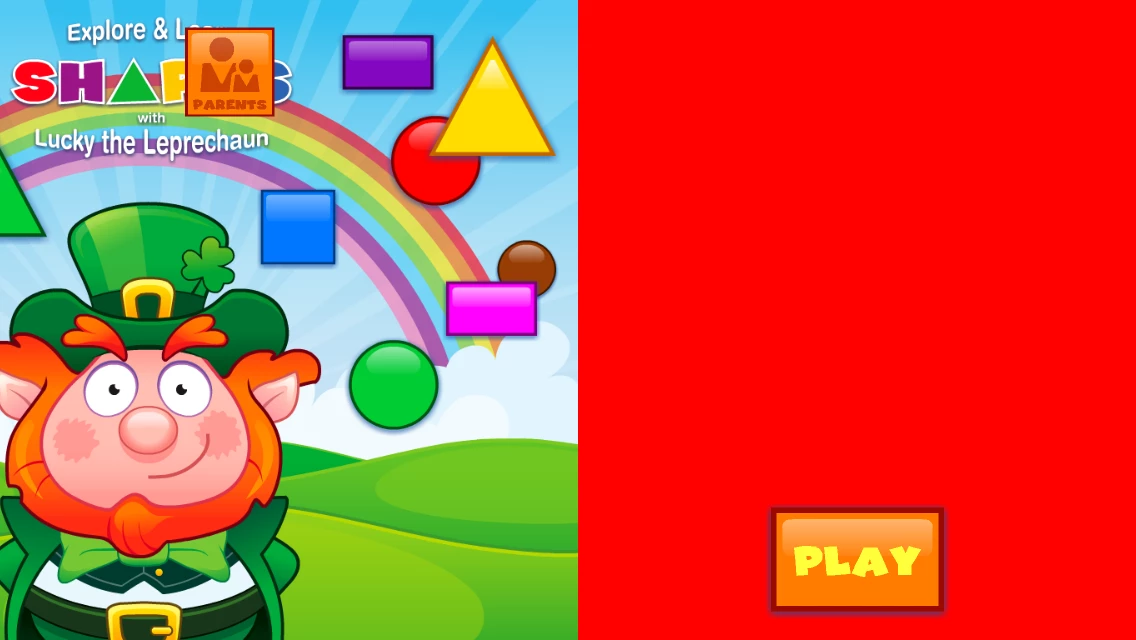

If I change my flash movie background colour to red here is the result. I have included a grab of the default loading screen here on the iPhone 5
Now as an experiment, I added some code to the play button to move the splash screen background to the left when the button was clicked and the result was as follows. So it certainly looks like it is possible to fill this "red" area. Perhaps the extra graphics need to be added dynamically for it to work?

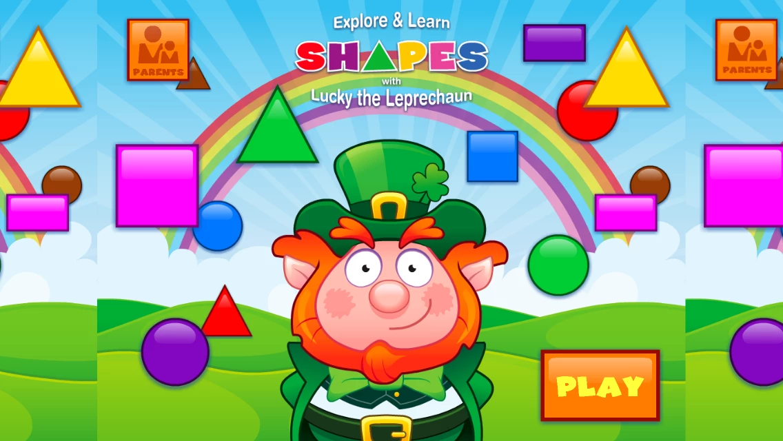

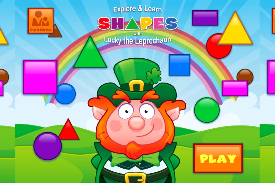

Since adding the iPhone 5 specific Default-568h@2x.png things seem to have changed as now when I put a duplicate of my splash screen to the left and right of the stage I get the following result on the iPhone 5. Which suggests I should be able to just extend the background graphic in both directions. This seems to still work fine on iPad2 and I have included a grab from iPhone4 too below.
iPhone 5 grab
iPhone 4 grab

From your tests I can see that you have the stage scale mode at its default of "show_all". That's fine, and you can just have the extra background images to the left and right of your 1024x768 stage. If that works out for each of your screens, and the extra background doesn't look out of place, then that's the easiest solution.
You will need about 1365 pixels width of background image on your 1024 stage, to make sure it fills the iPhone 5. The inclusion of the Default-568h@2x.png is enough for it to work for iPhone 5 locally, but to make sure it's acceptable to Apple you will want to use AIR 3.5 or 3.6. If your game play involves items moving in and out of the sides of the area, just make sure they come from beyond the edges of the 1365 background, so that on iPhone 5 the don't mysteriously appear out of nowhere.
