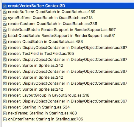

tepsl
Jan 14, 2017 6:26 AM UTC
Not everywhere but some we still have the same issue on iPhone5.
The error always occurs at the almost same source code point.
The debug stack trace is:
We are using Starling 1.8/Feathers 2.3.0 and iOS version is 10.2.
