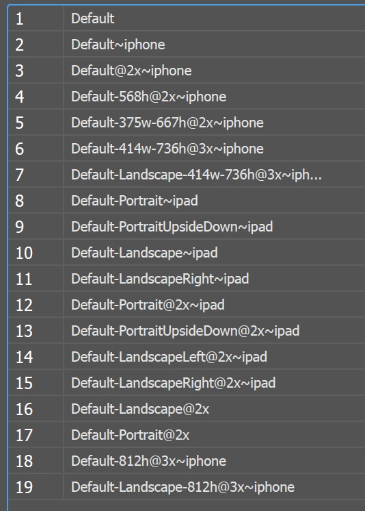

Nov 20, 2017 7:23 PM UTC
According to Adobe specs, this is the complete list with all iOS devices covered:
These are artboards from an AI file I use to export them all. If you want the AI pm me.
19 PNGs, sometimes splashscreens occupy more space than the app itself
