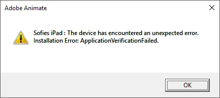

December 20, 2017
Sorry, it's working now. Embarrassed to say that the prov. file didn't have the iPad I tested
But Just to let you know I can now publish directly from the latest version of Adobe Animate to an iPad running the latest IOS 11, Using the latest Air 28.  (Itunes is version 12.6.0.100)
However the Icon for the app is not shown on the iPad but I've read that this doesn't work on IOS 11 when testing.

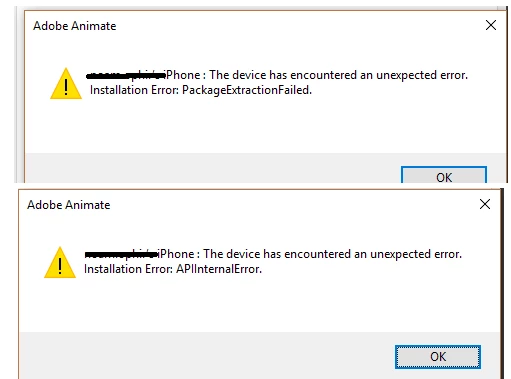

September 26, 2017
I also start having this problem.
When i install my app (via animate cc) on a device with ios 10.3.3 or lower - all is good.
[using AIR 26.]
But, after I have upgraded my iPhone6 to ios11 - I keep getting installation Errors:
what to do ??? Anybody ?
I have to publish this version ASAP...
The certificate & mobile provision is set for 'development'.

I had this problem from this weekend and i could not get my IPA to install on the iPhone running iOS10.3.
With some help, i could finally get it to work.
i had to use a free third party app on my mac to re-sign the ipa with the provisioning profiles and entitlements.
use this link to install the app called iRe-Sign and follow the simple app to resign the app and install on the device.
https://github.com/maciekish/iReSign
July 5, 2017
We are successfully able to install IPA on iPhone running on iOS10.3.3 with AIR SDK 26 using cmd line.
Could you please share more details about the issue your are facing.
Thanks
Aakriti (Adobe AIR Engineering)
