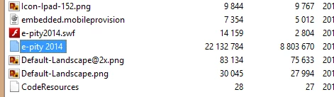

Feb 23, 2015 7:05 AM UTC
‌Anyone with this issue:
Rename IPA to ZIP and open it. Find your binary file inside and check it size firstly and report it here

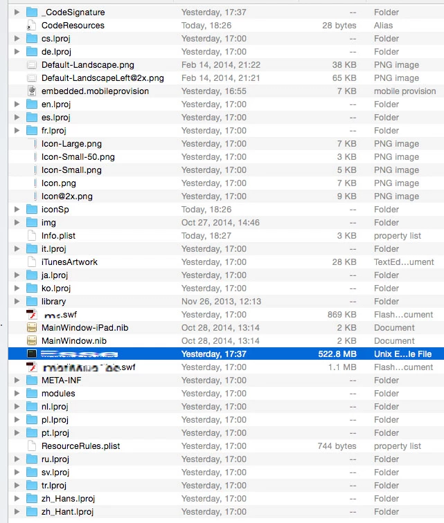

Feb 24, 2015 9:13 AM UTC
I have the same problem. My Unix Executable is over 500 MB and there is no way I can get it down to something like 80 MB. I've attached a screenshot of the contents of the .ipa file. Is there some workaround where a small executable can serve as the main file which simply links to the big executable?? Love to hear any suggestions/angles/options. Thanks
