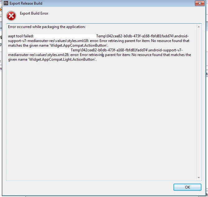

However, when I change to use < AIR SDK 14, the packaging works just fine. I have also google around this issue, and the reason is duplicate library android-support-v7-appcompat.jar in the ANE. It doesn't make sense to me when I only have 1 ANE in use in my project.
So I tried removing the library android-support-v7-appcompat.jar in the ANE file and repackaging the ANE, now it shows a different error as below screenshot. It looks like android.support.v7.mediarouter relying on android.support.v7.appcompat, so removing android-support-v7-appcompat.jar is not solving the problem.
