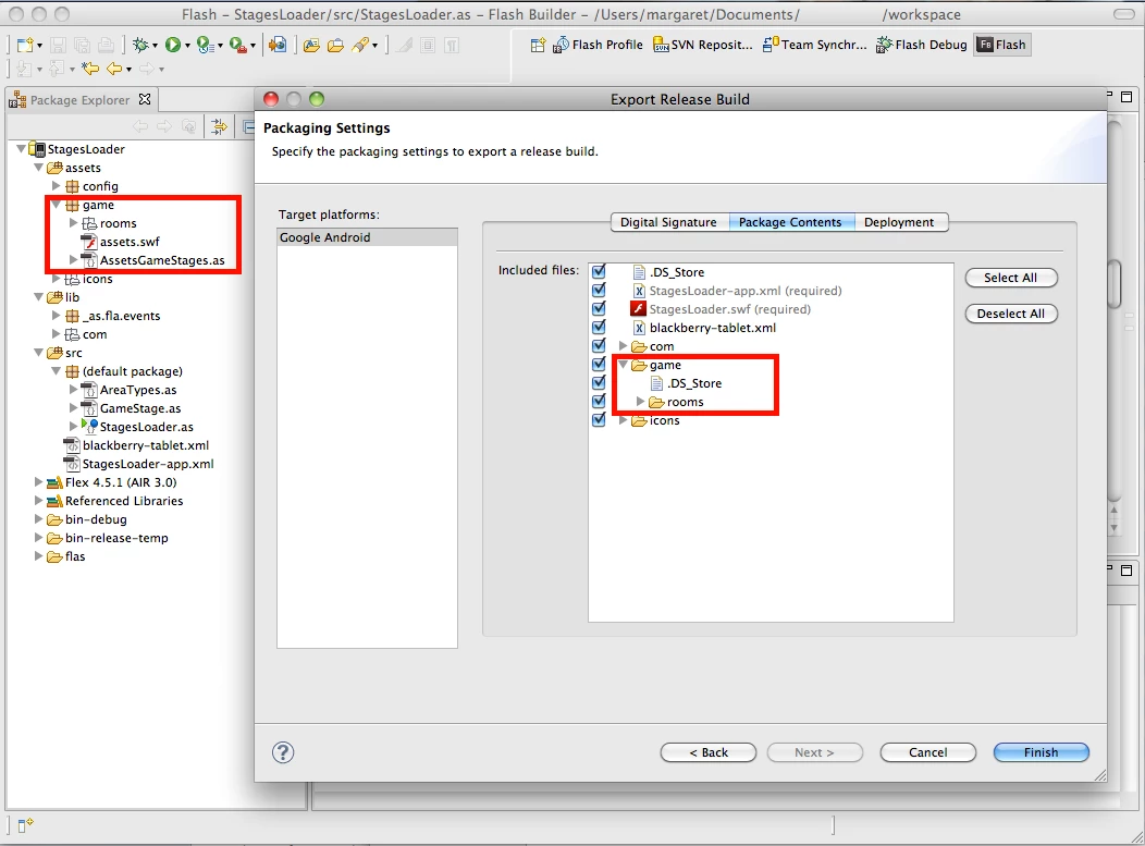

Thanks for the suggestion. I checked, but that doesn't seem to be the problem in my case. I've attached a screen shot showing the problem – the list of source files in the Flash view doesn't match the list of source files in the Export Release Build wizard. The red boxes highlight one of the areas where they differ.
The file I want to include is StagesLoader/assets/game/assets.swf. (The directory StagesLoader/assets is included into the project as a separate source path.) As you can see, the "rooms" folder in that directory is available in the export wizard, but "assets.swf" is not.
