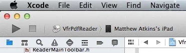

I've inserted an image to help explain it.
Basically where you can select the output target, in my case where it says 'VfrPdfReader' - you need to select a device output instead of a simulator output.
If I select a simulator device type then the ANE build fails with the above message. But, with it selected as per my image below, the build works fine.
Very odd behaviour...let me know if this works for you too!
