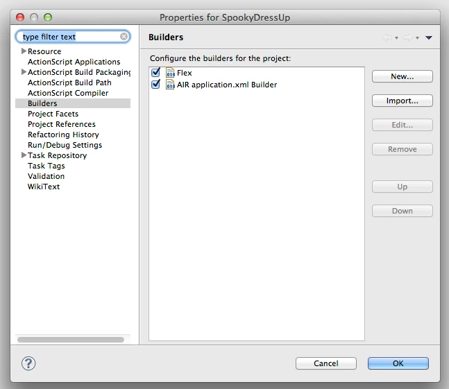

I found the Builders section of the project properties, and I can see where you would add the ANT task, but would this be a replacement for the Flex and AIR items in the Builders list already, or would it be added at the end?
