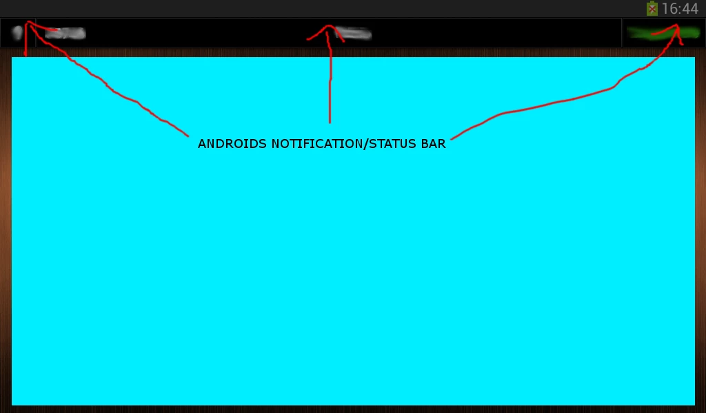

The application does in fact do everything it's supposed to but when the device boots up, the app does not starts in full screen because you can see the notification/status bar. Next you may see the problem.
What I need to do is to make the app start at full screen when the device boots. Now, the only way to make it start at full screen mode is to restart the application after the device finished booting up.

Further testing make me realize that when the status bar was showing, it was exactly the same scenario as when the **fullscreen** parameter of the manifest was set to false. Could it be a bug on the parameter fullScreen?
