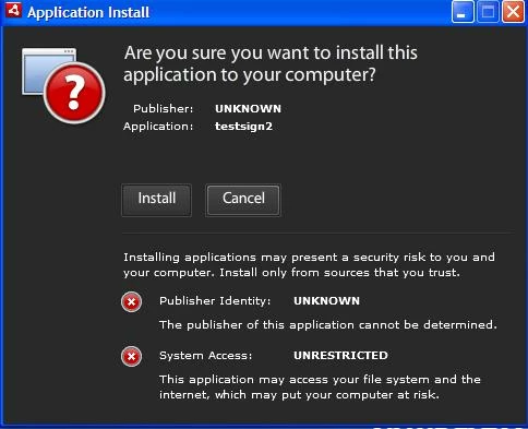

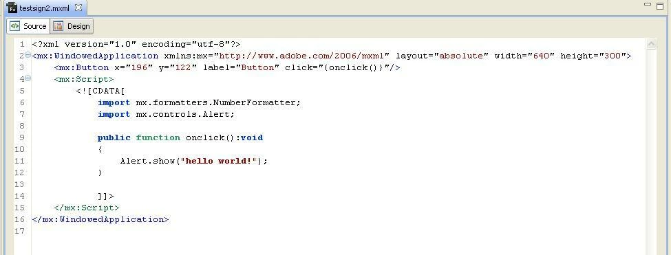

I am silly to use that open source project as a example without knowing what it is doing inside.(Just don't know how to share my air file with code)
In fact the problem happen to my simple project(only do a alert.show)
Here is the code and some screen capture
1) Code that simple do a Alert
Install not a problem
Didn't show up when run.
Is it because the mx name space required internet? What should I use if so?
Thanks a lot
Yes, but in very specific situations only:
http://forums.adobe.com/message/3716326#3716326
If your application uses Flex framework - but uses default settings "Merged into code" (default for Air type of project) that should not happen really. It's common issue trapping Flex-based applications that run standalone - but I think it should not happen for Air type of project - as it manages "merged into code" by default.
#3
(after you've provided simplified sample)
Is your application window visible then? If visible does any action is taken upon click?
