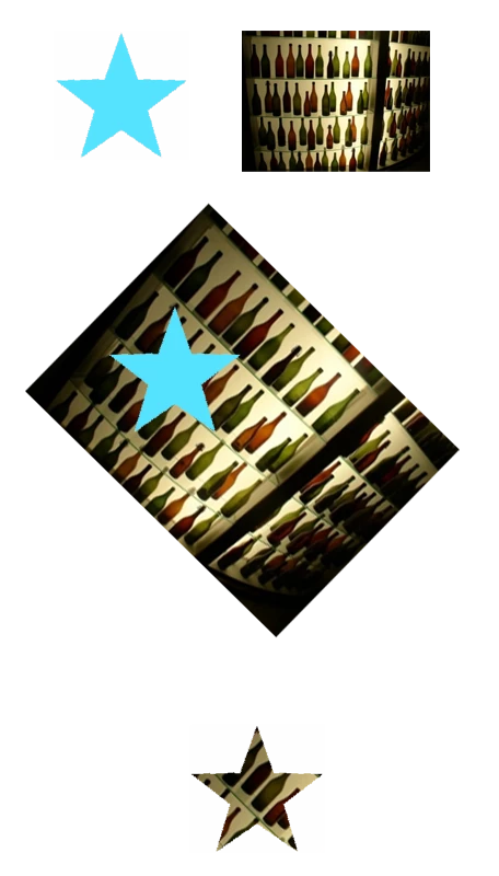

Hi , i´m trying to achieve a behaviour with bitmaps but a little bit confused.
Objective:
(As shown in image attached)
I have a Movieclip with a static Shape on Stage ( Let´s say ... a star)
I would like to load a image(img1) , then i would be able to, rotate, zoom , and pan the image(img1).
Then i would have only the star but filled with the part of the image that fitted that star.
I was trying to  get bitmapData from the image, then draw the star on the image.... And at end, compare color pixels and only getting the ones i want to.... but i get a big mess with the rotations, scale and position of star to be exactly on the place it should be draw...
Something tell´s me that i´m missing a point and it should be easier...
Can anyone give me directions ?
It´s a kind of masking, but i want to save that image only then...
Thanks in advance!

I would:
1) Move and translate your image clip
2) Set the star as the mask
3) Once the mask is applied, use BitmapData.draw to draw the masked image to a new bitmap data
4) TADA!
As far as I am aware, 'draw' should respect masks? If it doesn't then you may need to put clip+mask inside another DisplayObject and draw that.  Some psuedo code (not tested, and simplified):

gonMiguel
gonMiguelAuthor
Apr 3, 2014 12:08 AM UTC
Hi Pea ! Thanks a Million, i knew that i should look from other prespective !  I was complicating to much and not getting results !
I was drawing into the rotated and scalated image, and this really help things !
Actually i had to make minor changes to obtain what i wanted to achieve:
var bitmapData = new BitmapData( Math.ceil(star.width), Math.ceil(star.height), true, 0x00000000 );
var mx:Matrix = new Matrix();
mx.translate(-star.getBounds(canvas).x,-star.getBounds(canvas).y)
bitmapData.draw( canvas,mx);
So that i got only bitmapdata of the size of the mask, and the translation, to move it to (0,0) of bitmapData .
