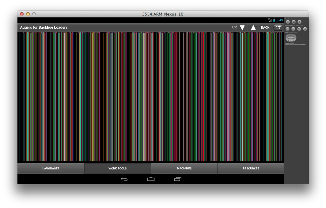

I am having a similar issue when loading an external swf. Some of the loaded swf files display fine, while others display as seen in the attached screen shot, but only on the Nexus 10 device or emulator. I'm setting cacheAsBitmap to true on the loaded swf since it contains vector graphics. If I don't set the cacheAsBitmap property, then the problem goes away, but then the display performance is worse. Perhaps it is related to the higher resolution screen somehow on the Nexus? It seems like a bug to me tho. Has anyone found a fix or work around?

Maybe you can try blitting your vector graphic into a bitmap for now. I had a problem that whenever I change the rotation of a vector graphic that is cacheAsBitmap, the text within the graphic will be messed up.
Blitting is extra work and, in my case, the quality suffers a lot when I rotate the bitmap, relative to rotating a vector graphic. I kept the vector graphic visible=false all the time, and kept it and everything within cacheAsBitmap=false. Just in case it does anything fancy.
You might run into a problem if you blit a scaled vector graphic though. Because bitmapData.draw() doesn't blit the scaled image by default, so the blitted result will be unscaled. I remember solving the problem by using a matrix when blitting, I think.
Anyways, at least that got the job done. It's almost like cacheAtBitmap manually, and painfully. Hope it helps. When in doubt, just blit the crap out of everything
