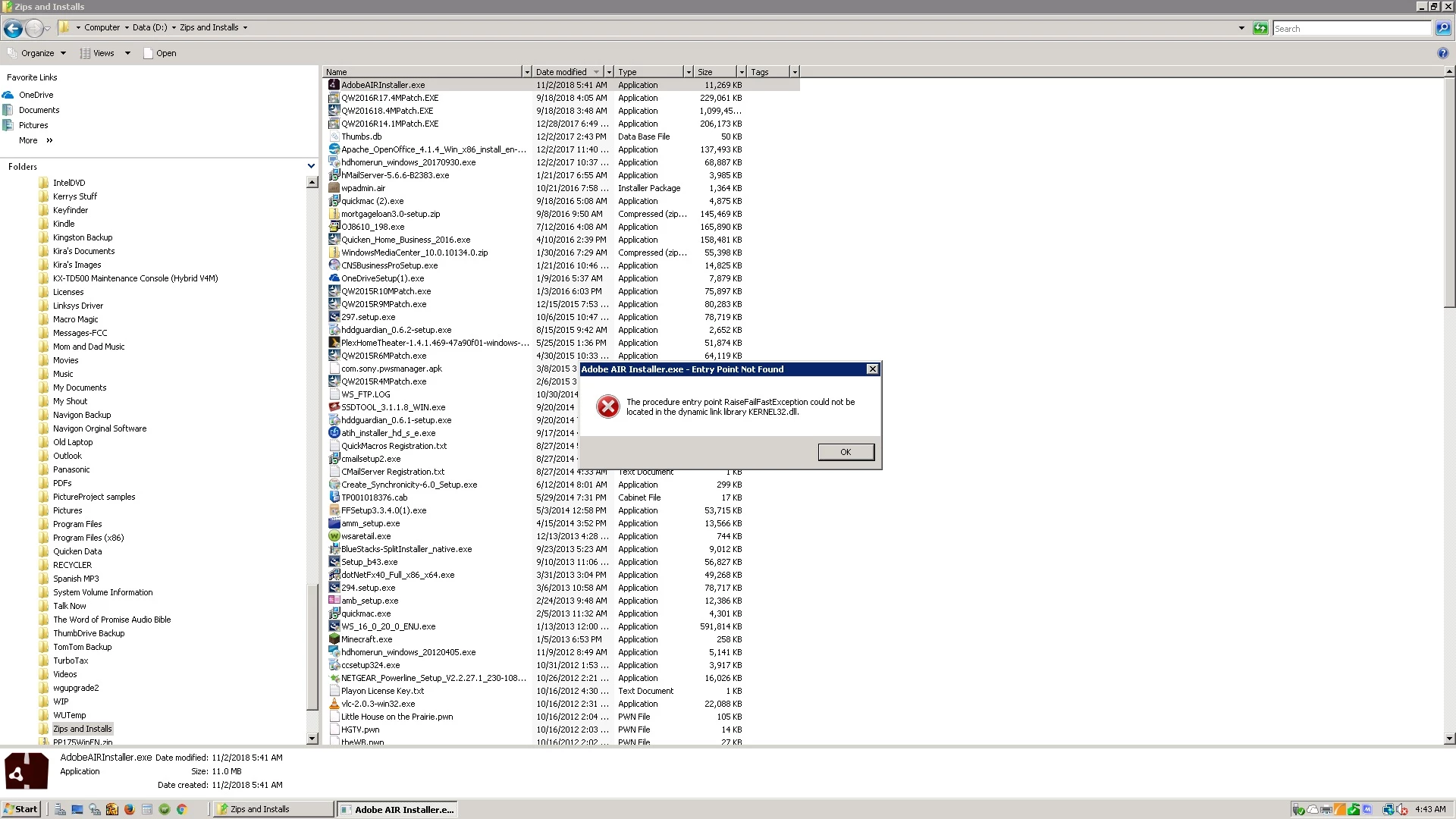

Can't get Adobe Air 31.0.0.96 Installed on Windows Server 2008
I have been using Adobe Air for over a year on my Server 2008 terminal server environment. A few months ago I could not install the latest Air update which my application needs. When I try to install it I get: The procedure entry point RaiseFailFastException could not be located in the dynamic link library KERNEL32.dll. When I click to acknowledge that I get: This application requires a version of Adobe AIR which cannot be found. Please download the latest version of the runtime from http://www.adobe.com/go/getair, or contact the application author for an updated version.

Nov 5, 2018 9:08 AM UTC
Are you seeing issue installing Adobe AIR or your application? Could you post a screenshot of the issue. Are you running using Admin privileges?

pcnetwrxAuthor
Nov 5, 2018 11:50 AM UTC
I am logged in as an Admin and also Running As Administrator.
Attached is a screen shot.

Nov 12, 2018 9:49 AM UTC
Thanks for sharing the screenshot. The issue is not related to AIR installer but seems like some of your OS files are corrupt. Please run System File Checker Tool to fix this issue. You can refer to The procedure entry point could not be located in the dynamic link - Microsoft Community  link for the same.
