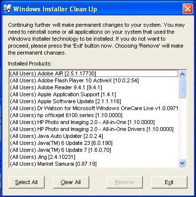

Step3. You will need to run the cleanup utility program by doing the following:
Step4.Go to Start=>All Programs=>Then find Windows Install Cleanup ...Double click the icon to launch the utility program.
You should see this window open:
Step5. When the window opens...look for a file named Adobe Air [1.?.?] as the version. (Mine has the new version installed so you can see it at the very top entry.
Step6. If you see Adobe Air listed with a previous version...select it and the remove button will become active. Click Remove.
Step7. The utility will remove all the previous version of Adobe Air.
Step8. Grab the latest version of the Adobe Air runtime and Install it. In my case, the new version of Adobe Air installed right away with no problems.
Summary: I think that my mistake was assuming that the installation of the windows cleanup utility was the actual cleanup process. It's not...you have to install the utility and then go to Step3 and actually run the utility after you have selected the outdated version of the Adobe Air.
