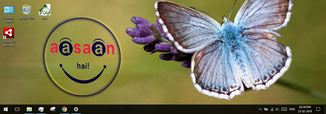

Feb 25, 2018 9:10 AM UTC
Hello everyone!
u can install SettingsManager.air simply by changing the time in pc settings to the year 2015 or 14...i just tried it out works fine then u can update the time again on pc.
