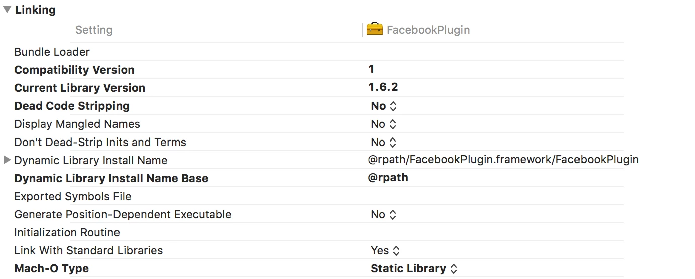

i'm building an ANE that ships with dynamic and static frameworks. As long as it is only dynamic frameworks, everything works fine.
I have one FacebookPlugin.framework that is build as a static framework though - in XCode that framwork has the MachO-Type "static library". I can't build it as a dynamic framework due to reasons.
