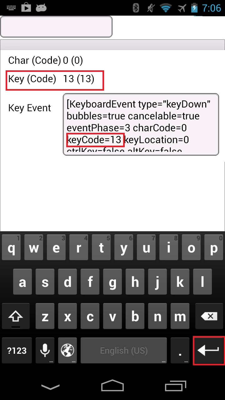

Could you please confirm the Enter key you are talking about. Is this the same as marked in red on the softkeyboard in the attached image.

Yes, that's the button I was talking about. Although I can see you're getting keyCode 13 when you try it. Here's what I see:
1. I bring up a login screen with 2 input textfields on (not stagetext, just normal single line input textfields). Then I tap on the username.
2.  I get this alternative layout alongside the soft keyboard (maybe because my app is in landscape?). I enter username and tap the key marked in red.
3. The debug console traces this when I tap the key marked in red:
Key Event: [KeyboardEvent type="keyUp" bubbles=true cancelable=false eventPhase=2 charCode=10 keyCode=10 keyLocation=0 ctrlKey=false altKey=false shiftKey=false controlKey=false commandKey=false]
