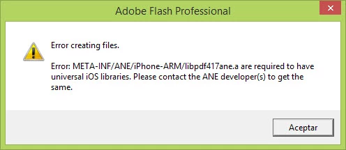

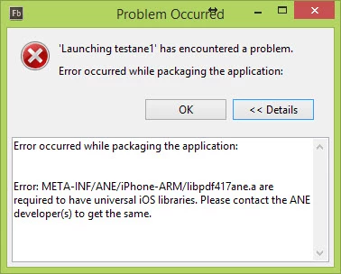

I was having the non-universal message when building up my ane but I fixed it by setting the ios Target to 6.1 and setting manually the architectures to armv7 armv7s and arm64 (using xCode 6.1 and air sdk 16 build 272) . Now I can compile the ANE but when I tried to test it on Flash Pro I am getting this error:
I have tried downloading last AIR SDK 17 but not luck, any ideas? Btw I have confirmed with lipo -info that the library is fat

Feb 11, 2015 12:00 PM UTC
I have cleaned the cache, created a new project and even tried the ANE using Flex on Flash Builder and still getting the same error

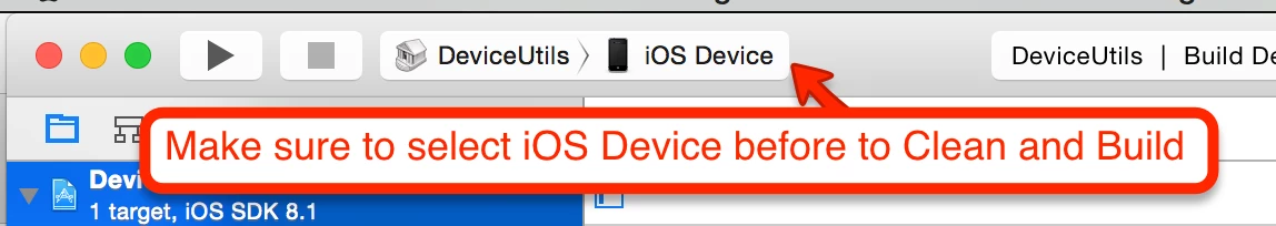

Feb 1, 2015 5:45 AM UTC
If you are having this issue, this is how you can solve:
