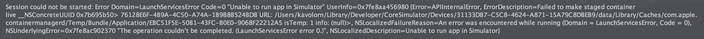

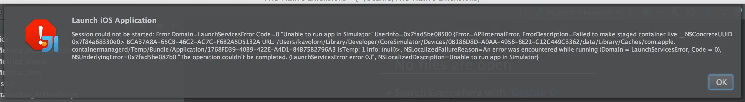

Ah, sorry.. Here are details:
I use OS X Mavericks with IntelliJ IDEA 14.0.1, Xcode 6.1 and AIR SDK 16.0.0.222 (where I changed <sdk>/lib/aot/bin/isb/isb with one provided by Govind@adobe). I have run configuration to launch in ios simulator. I use /Applications/Xcode.app/Contents/Developer/Platforms/iPhoneSimulator.platform/Developer/SDKs/iPhoneSimulator8.1.sdk path as ios sdk path.
When I click run for the first time everything works fine. Simulator is loading and installing app and launching it correctly. Now if I will press run once again (with simulator opened) I have this kind of error:
Session could not be started..
If I will close my simulator with Command + Q and press run again everything is working correctly again. So for my environment isb patch is working partly and I have to close simulator each time I want to run my app. Before this patch nothing was working at all.
Does anyone have the same situation?
