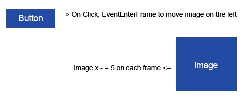

So, i have made a test, with just two elements :
- An image (PNG)
- A button (made with PNG image)
When i tap on the button, the image move to the left by 5px each frame with "EventEnterFrame" .
With this test, the problem is the same. On Galaxy S6 no lag but on Galaxy S4 a random lag during the scroll.
Here is the simply code :

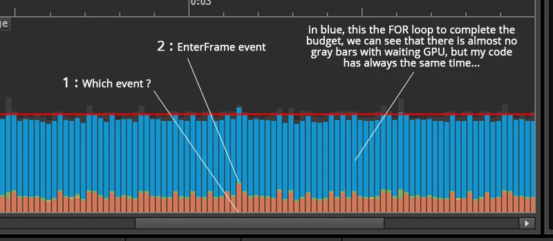

For just this test, it correct the problem of lag so the approach is good, but the time of execution code in loop is always the same. I still have a problem  to calculate the time between the begin of rendering and end of rendering.
With your information, now i know that the enterFrame event is the end of rendering (and i have confirmed that with a test).
So i have the time of end of rendering, now it miss just the time of the begin of rendering.
Here is a capture of AdobeScout to be more understandable :
So, in 2 after the red and green bars, this is the enterFrame event. I would like to know the time between 1 and 2 in enterFrame.
But which event is ? I think if AdobeScout can calculate it, we can too...

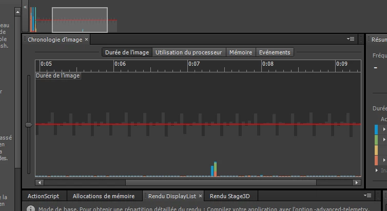

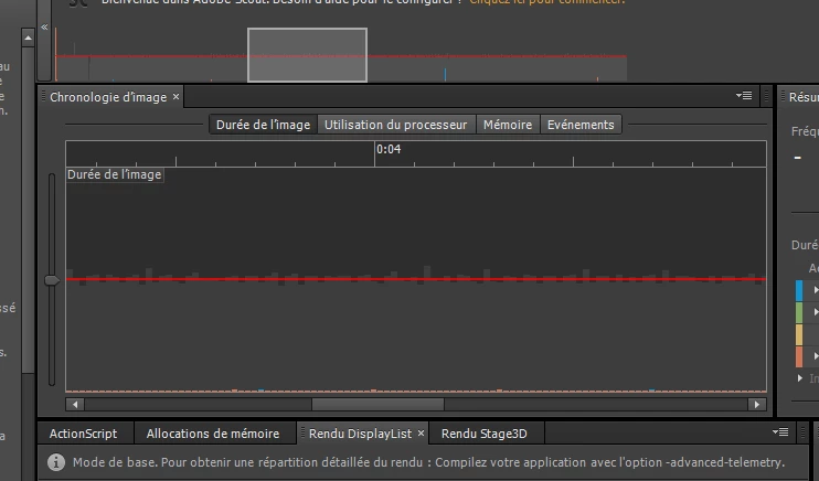

Here you can see the charts of just a rectangle in the scene at 30 and 60fps in adobe scout :
30 fps, we can see that the framerate is not stable...
And at 60fps, the framerate is more stable....
