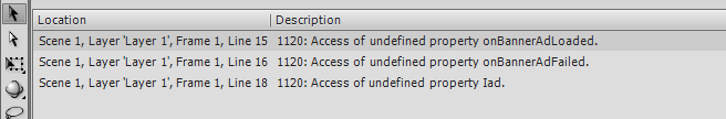

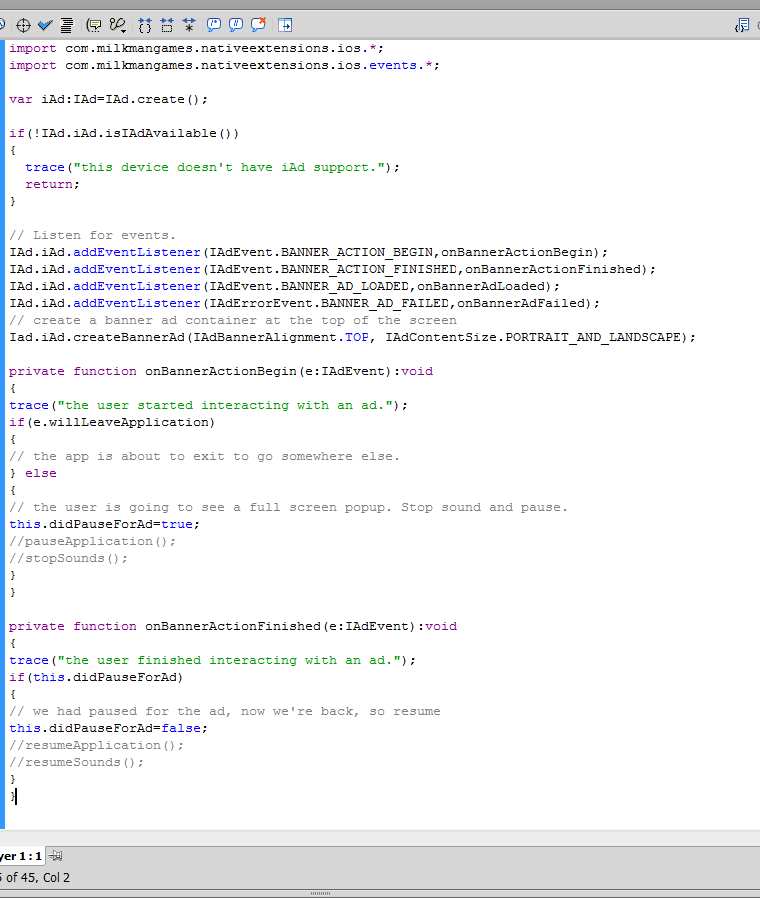

I recently purchased the iAd extension for ios package from milkman and am having trouble implementing it.
I have followed the Getting Started document but am having no joy. I have attached some screenshots to show how it is set up and the problems.
1) API library included
2) Code used in first frame of test app file
3) Errors received when publishing
4) Errors received when private is taken out
5) When I turn strict mode off and publish, I just get a blank white screen when viewing the app on my iPhone.

Your problem is right there in the errors. Looks like you are coding on the time line instead of the class. That's fine, but that means get rid of class related things like private function and extends class stuff. That is what your first error is about. When you do that you are getting the second error, here I can see in your code you have set up the listeners for those 2 functions but you do not have the actual function onBannerAdLoaded and onBannerAdFailed. Find those two in the docs or below add them to your code.
function onBannerAdLoaded(e:IAdEvent):void
        trace("banner ad loaded.");
private function onBannerAdFailed(e:IAdErrorEvent):void
        trace("banner ad failed");
The last error is a typo on your part. In line 18 you have a lowercase ad as in Iad it should be IAd, remember flash is very case sensitive. So change it to this.
IAd.iAd.createBannerAd(IAdBannerAlignment.TOP,IAdContentSize.PORTRAIT_AND_LANDSCAPE);
