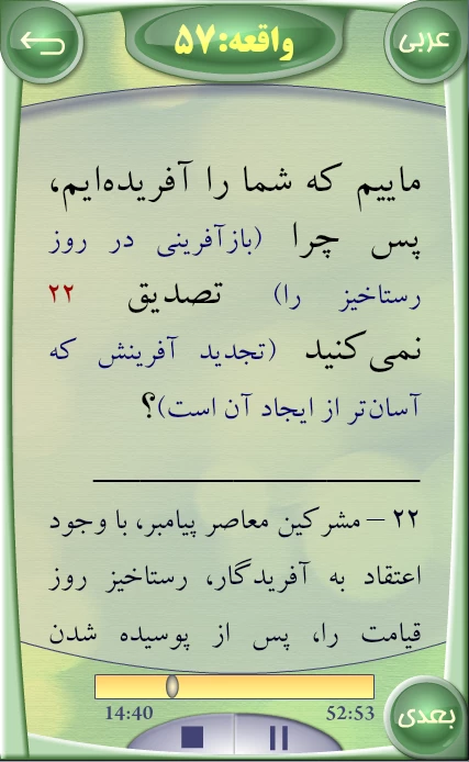

Actually I have no experience with Native extensions so far, even while I've developed some apps for Android and iOS using Adobe Flash CS6, that they happen all to have sound players as well.
The problem is, in my Apps (sample below) I have programmed the ability to let users Play / Pause / Stop (Navigate) the MP3s that will be downloaded from Internet based on their selection. as this player is NOT using the iOS native player, consequently, the main negative results are as follows:
- App does not catch downloaded mp3 files for offline use or if WIFI disconnected suddenly (unlike iOS player)
- in Lock screen, Users do not have access to the playback of sound.
- wireless FM transmitters or other kits used in cars, can not control the playback unlike iOS internal player.
