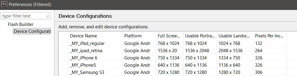

Jul 29, 2018 1:59 PM UTC
What I usually do is just use the AIR simulator in FlashBuilder but say the target is Android, and then create custom configurations that match the various iOS devices... for example:
HTH

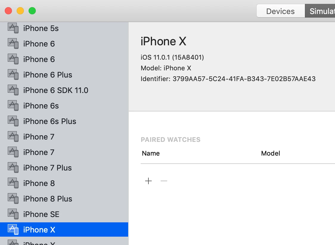

Colin Holgate
Jul 26, 2018 3:45 PM UTC
I don't know of a way to do what you're asking, but i know a way to do what you want. I'll write an article about this some time, but here are the basics:
Say you want to test your app on iPhone X, iOS 11.0.1. In the Devices and Simulators window in Xcode is a list of Simulators, if you select one you see its Identifier, which is also the name of the folder in Finder:
The simulator folders are in here:
~/Library/Developer/CoreSimulator/Devices/
In my case ~/Library/Developer/CoreSimulator/Devices/3799AA57-5C24-41FA-B343-7E02B57AAE43/ is that iPhone X simulator. If you also look for the identifier for the simulator that Flash builder is invoking (can be any of the ones it can do), you can find the folder where it installed too. Imagine these are them:
If you delete the data folder in the iPhone X one, and copy across the data folder from the simulator that Flash Builder installed into, you can then open an iPhone X window in Simulator, and your app will be already installed.
