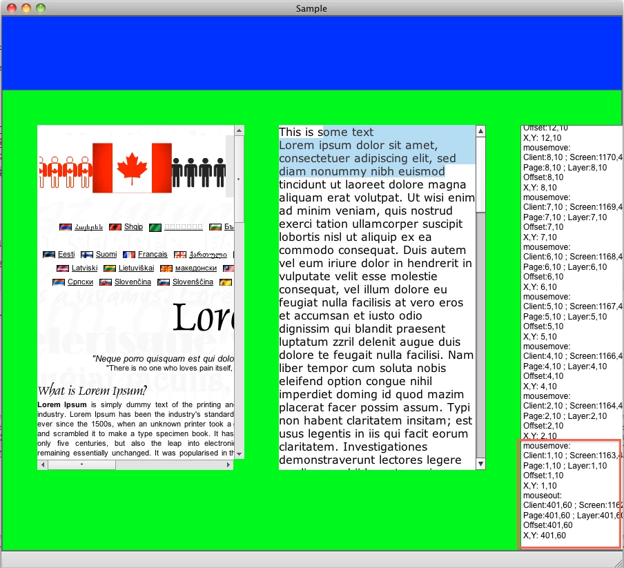

We have a desktp application which incorporates an HTMLRichTextEditor (implemented in HTML/JS and loaded into AIR).
We have run into a big problem with text selection though. It seems that the both the HTMLLoader and the StageWebView are passing wrong mouse coordinates to the WebKit when the cursor is outside of the component.
I've created a sample application which uses mx:HTML (which is a wrapper of the HTMLLoader) and a WebView class (a wrapper aroun StageWebView reference to which is given here).
The application is located here in Dropbox. The source code of the app is here.
The app was built with Flex 4.6 and ran in AIR 3.7
The sample app has a WebView which loads loremipsum and HTML loading some dummy local HTML page. The HTML page uses the JS->AIR bridge to report the mouseevents to a function in AIR. In the snapshot below the selection was started from the first row and then slowly continued to the left. As soon as it reaches the green area the selection changes unexpectably. As it can be seen in the bottom right -> the WebKit has received a mouse event with incorrect coordinates. The reported mouse coordinates seem to be the mouse coordinates within the green component and the selection behaves like that. If the mouse is moved to the blue - the selection changes again (according to the coordinates in the blue area).
The component which uses the StageWebView behaves in absolutely the same way.

I've tried a few workarounds in order to stop and ongoing selection or to change it's behaviour but none of them with any relevant success. Even disabling mouse children for the entire application has no effect on the selection once it's started.
