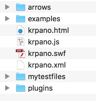

krpano has a lot of folders in it. Any particular example may be using code from folders inside folders that are higher up in the site. You may need to reproduce their hierarchy, and to include some files that their code is relying on. Here's a screenshot of the folders I had to include to get a test going:
