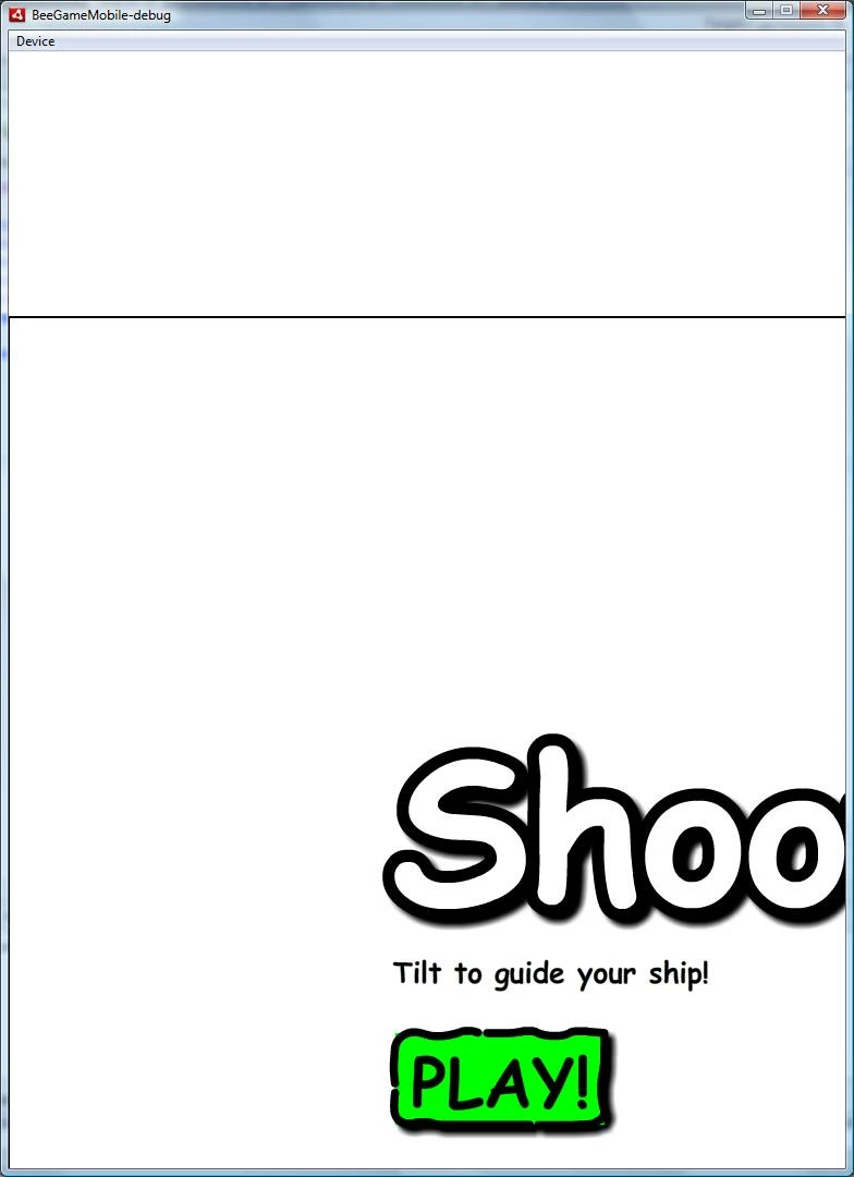

Except that that doesn't work either:
Note how it's too large (by almost double) and the top edge of the main object is, oh, 185 pixels below the top of the iPad.  Rotating the iPad doesn't solve the issue.
Colin Holgate
Feb 8, 2012 4:51 PM UTC
To get that screenshot, what remaining scale and align code do you have? What x and y values are you using for the game movieclip?
