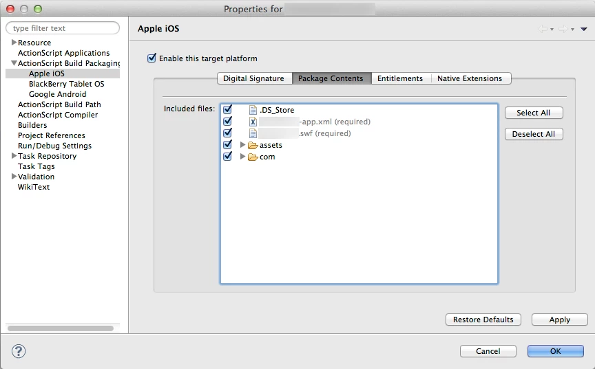

Reading there about checking that the images appear on the Build Packaging has me wondering if I'm doing something wrong at that part. Here's a cap of my build packaging screen:
The launch images don't appear there, and I can't find how to manually add them there.

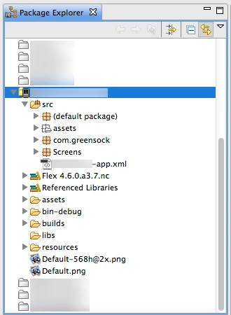

The images are at the root of my project, as you can see here:
How can I ensure that the images are being packaged correctly? When I first tried to send the App, the Application Loader complained that there was not a launch image, which I fixed by creating a Default.png, placing it at the project root and re-compiling. So at least that image seems to be packed correctly.

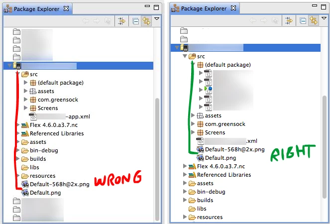

Problem solved, so here's what worked, in the case somebody else has the same issue:
Colin Holgate
