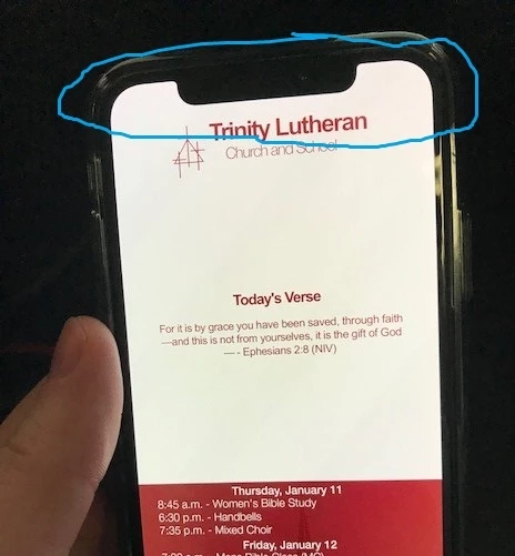

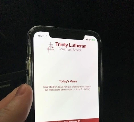

I have attached photos from AIR apps I work on. I am having issues with the iPhone X specifically.
I am running,
-Latest iOS
-Latest AIR 28
-Complied via Flash builder (Mac OS 10.12.6)
-Both apps successfully were submitted to app store
-Both apps are opened from test-flight beta testing
When the app opens up I can see the status bar, however after a period of time the status bar doesn't show up on the top. I cannot figure out what causes this, I have tried app switching and opening and closing the app. The behavior seems random, however when it occurs - it remains. Any ideas on this are appreciated.
