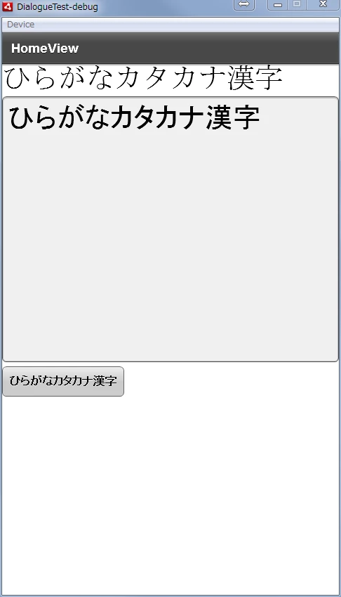

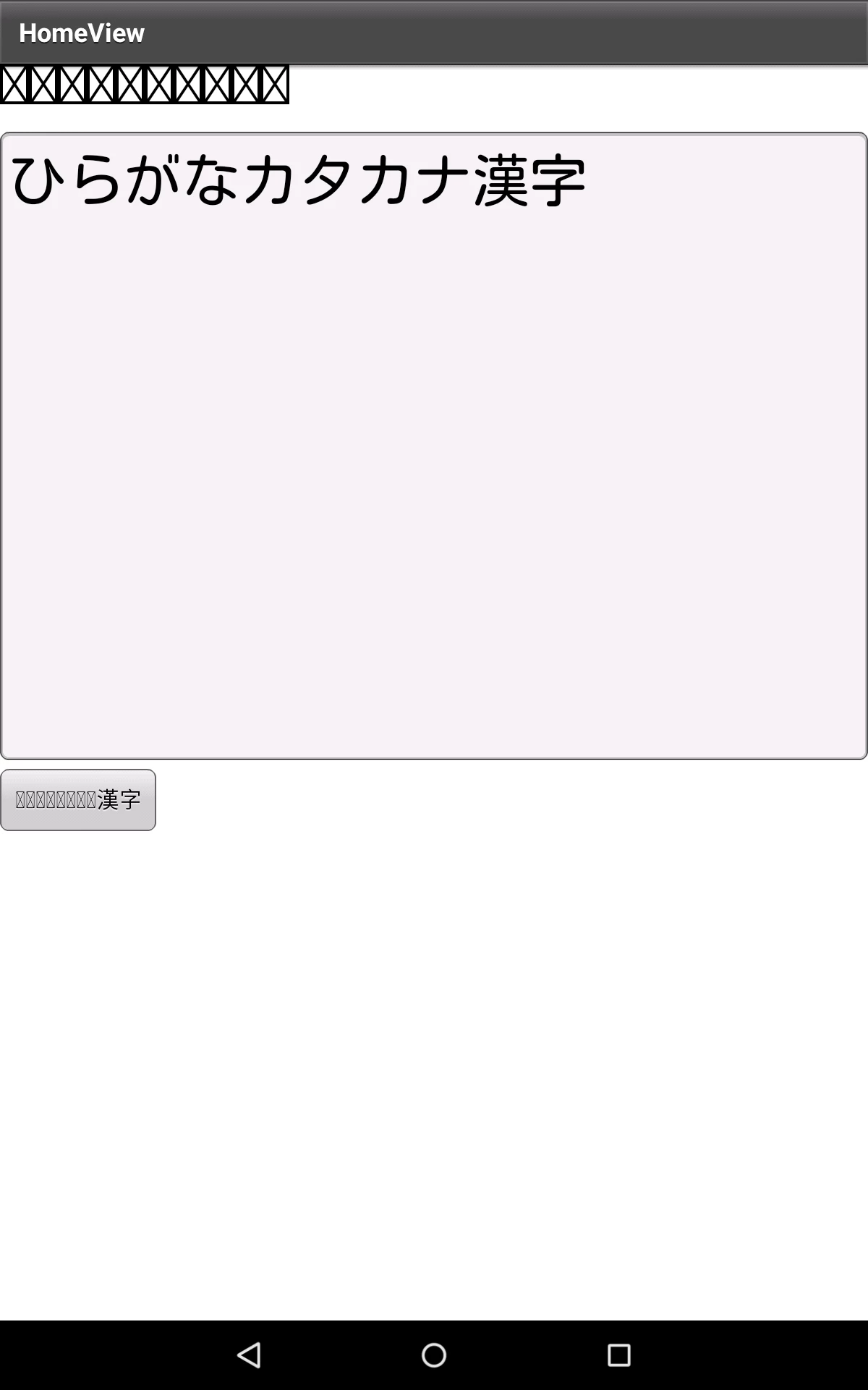

Japanese indication of Label and Button is strange in Android5.0.1.
A screen of attachment is Label, TextArea, Button in turn from the top.
TextArea is normally indicated, but all hiragana, katakana and kanji aren't shown to Label.
Hiragana and katakana aren't shown to Button.
Nexus7(2013) Android5.0.1 AIR15.0.0.381
AIR Simulator

Hi Shoji,
It seems that my problem is fixed using AIR 16, may be you can give it a try.
Cheers

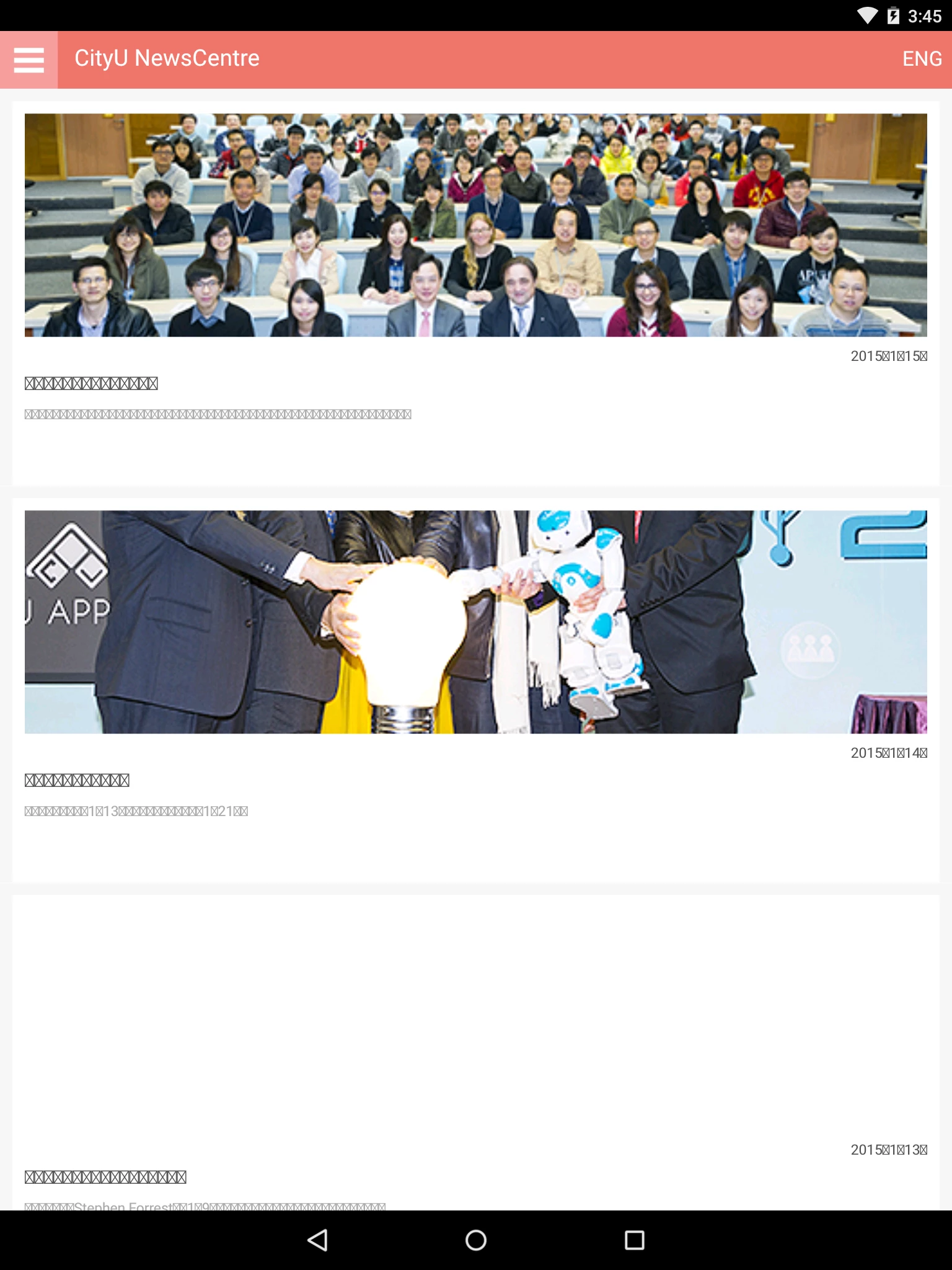

Jan 16, 2015 8:40 AM UTC
Hi Ankit,
Not sure if this is a right place to raise, I also found that the Spark Label is not rendering Chinese characters correctly. Attached is a screen shot for your reference.
Testing Environment
Android 5.0.1
Apache Flex 13
Adobe AIR 15
The same application works well on Android 4.x.
Cheers

Jan 16, 2015 9:34 AM UTC
Hi Vicker,
Thanks for reporting the issue. If possible could you please share your project with us? This will help us in investigating the issue. You can share the dropbox link of the same at anki@adobe.com.

Dec 24, 2014 7:40 AM UTC
We verified it at our end and was able to reproduce it for Label. All Hiragana, Katakana and Kanji characters aren't shown to label.
But were not able to reproduce it for Button. We tried with the below Hiragana and Katakana characters.
Hiragana:  の, は, でした
Katakana: コンサート
Probably the issue does not exist in case of buttton for all the Hiragana and Katakana characters. Could you please share the set of characters you used. It would also be fine if you could share the project with us.
Dec 24, 2014 11:16 AM UTC
Thanks for your reply.
I experimented on the following characters (UTF-8).
Hiragana
ひ E381B2
ら E38289
が E3818C
な E381AA
Katakana
カ E382AB
タ E382BF
カ E382AB
ナ E3838A
Kanji
漢 E6BCA2
字 E5AD97

Dec 24, 2014 11:49 AM UTC
We tried with the given list of characters but the issue is not reproducible in case of button for any of these. Could you please share your project with us.
